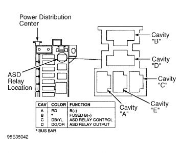

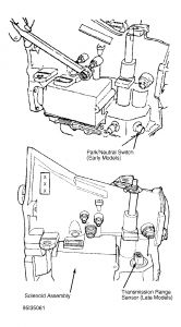

battery test; good, starter test; good, will not turn over. I was told it was the neutral safety switch;
is that on the inside or outside of the transmision.
Sunday, January 4th, 2009 AT 6:14 PM
ZACKMAN
MECHANIC
4,202 POSTS
It is on the outside of the transmission.
I would also check the ASD relay.
