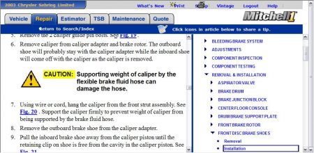

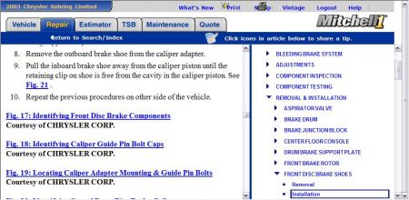

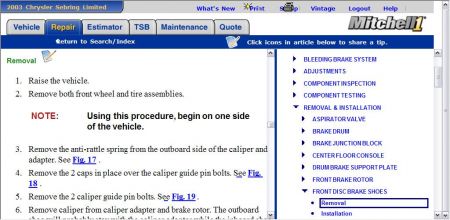

Could you please tell me how to change the front brake pads on the 2004 Chrysler Sebring?
Oct 21, 2007 at 9:08 AM
MERLIN2021
  • 17,250 POSTS
Two 12 mm bolt hold the caliper on, push the piston back all the way by getting betwee the old pad and the rotor with a screwdriver. then remove the caliper and rotor if you are changing it, install is the reverse!
Oct 21, 2007 at 9:19 AM
  • 75,988 POSTS
Installatiion reverse removal
https://images.2carpros.com/forum/automotive_pictures/12900_2004_sebring_brake_pad_1.jpg
https://images.2carpros.com/forum/automotive_pictures/12900_2004_sebring_2_1.jpg
https://images.2carpros.com/forum/automotive_pictures/12900_2004_sebring_3_1.jpg
Oct 21, 2007 at 9:27 AM
Suggested Repair
Remove the two 12 mm bolts holding the front caliper. Compress the piston fully by prying between the old pad and rotor with a screwdriver, then remove the caliper and the rotor if it is being replaced. Install the new pads and reassemble in reverse order.
