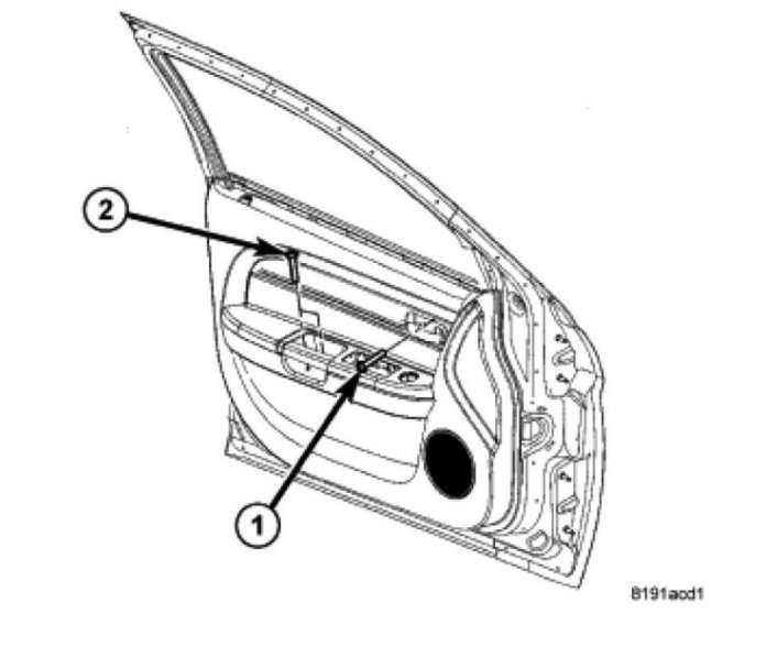

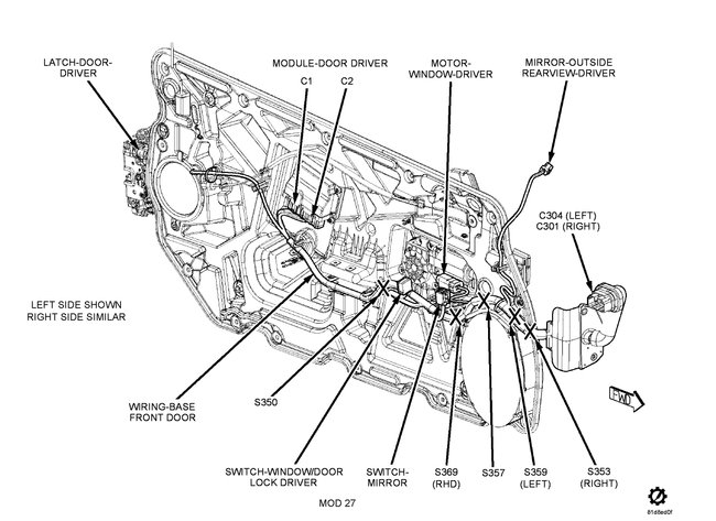

WHITEBUFFALO
2001 Chrysler Sebring
When we attempt to open the door from the inside, it simply won't open. We need to roll down the window and reach outside and open the door using the outside handle.
Any thoughts?
Aug 22, 2019 at 11:34 AM (Merged)
ZACKMAN
  • 4,202 POSTS
Remove the door panel and make sure the door lock linkage is actually attached to inside door handle. A lot of time, the plastic retaining clip breaks off of the linkage from the handle.
