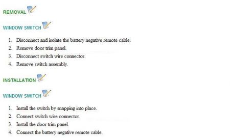

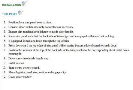

I spilled some coffee on my drivers door window switch and it is now gummed up.I would like to remove it and possibly clean it up or replace it.How doI remove this switch? Do I need to remove the door panel?Thank you,ernest

https://images.2carpros.com/forum/automotive_pictures/261618_Noname_1807.jpg
https://images.2carpros.com/forum/automotive_pictures/261618_Noname2_576.jpg
https://images.2carpros.com/forum/automotive_pictures/261618_Noname3_223.jpg
