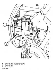

battery location please i need to replace it?
Mar 1, 2009 at 11:57 AM
OBXAUTOMEDIC
  • 3,711 POSTS
Hello, It is locate in front of the drivers front wheel well here is a guide to help step by step with the battery location below. https://www.2carpros.com/articles/how-to-replace-a-car-battery Check out the diagrams (Below). Please let us know if you need anything else to get the problem fixed.

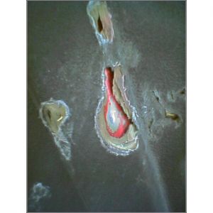

A replacement battery is purchased with a taller and larger battery for more cranking amps. If the battery post makes contact to the metal of the underhood, could it cause the car to just die randomly while driving the car and then take a few minutes or even up to an hour before it starts up again then drives and randomly die again?
https://images.2carpros.com/forum/automotive_pictures/215369_218325057413_0_1_1.jpg
Oct 22, 2020 at 3:46 AM (Merged)
MHPAUTOS
  • 31,937 POSTS
Hi there,
If the battery is shorting out on the bonnet, you run the risk of do considerable amount of damage to the electrical system, including spiking the ECU and destroying expensive equipment. Get the correct battery fitted.
Mark (mhpautos)
