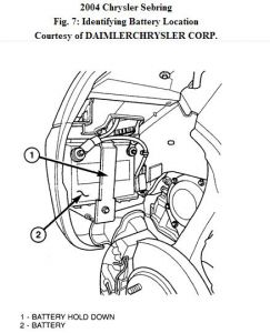

Where is my battery I looked under the hood but no battery in site. Is hid in there some where under or somewhere else. My battery post are lloose and need to be tighten

Go through the hatch in the wheel well.
Turn wheel fully left.
Disconnect terminals.
Remove the panel from the left wheel well.
Remove the battery hold-down

For the coupe it is under hood covered by battery cover. For the convertible it is in front of driver side front wheel, pictured below.
https://www.2carpros.com/forum/automotive_pictures/261618_Noname2_97.jpg
