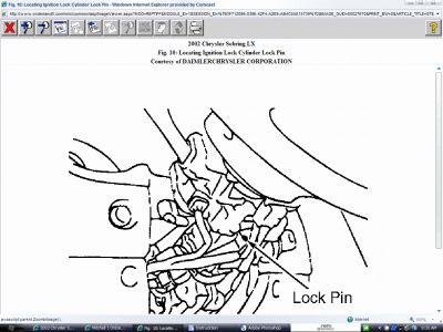

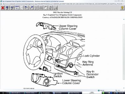

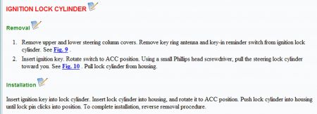

When you put the key in the ignition you can not turn it at all and the car will not go into gear. I have tryed turning the steering wheel to see if it got lock when parked and no luck. What do you suggest?

Dissconnect the Neg(-) cable from battery. then proceed with these steps to change the tumbles.
https://images.2carpros.com/forum/automotive_pictures/62217_Instruct_1.jpg
https://images.2carpros.com/forum/automotive_pictures/62217_Removal_1.jpg
https://images.2carpros.com/forum/automotive_pictures/62217_Lock_Pin_1.jpg
