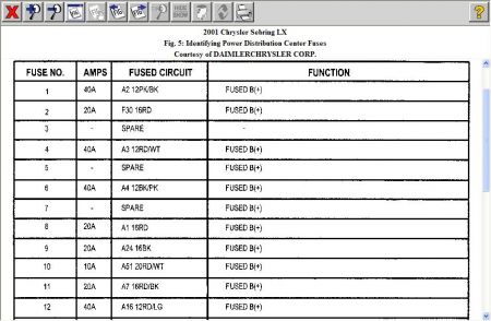

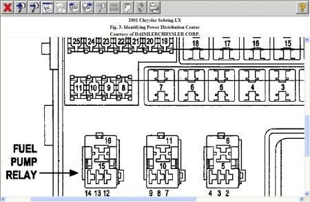

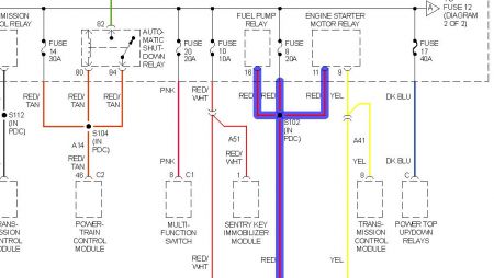

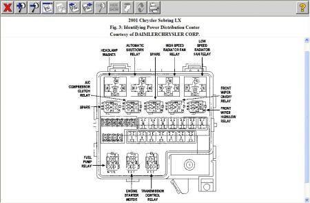

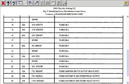

Hi John, Thank you for the input. Yes, that helps and I believe I have gotten the correct diagrams for you.
https://images.2carpros.com/forum/automotive_pictures/192750_PDC01SebringLXSedan_1.jpg
https://images.2carpros.com/forum/automotive_pictures/192750_PDC01SebringLXSedan01_1.jpg
https://images.2carpros.com/forum/automotive_pictures/192750_PDC01SebringLXSedan01a_1.jpg
Just to confirm this so I don't go on a wild goose chase. 1. The diagrams are correct ? 2. Fuse mentioned is # 22 ?

Yes that is the right fuse box.
I belive 22 is the right fuse but can't tell what number goes where from the disagram.
It is the 4th fuse from the left, pasenger side, in the row directly above the fuel pump relay going towards the windshield. There are only 4 bus type fuses in this short row. Starting on the passenger side the first 2 fuses are 20A, then a 10A then this one which is a 20A. Hope that helps confirm what you were thinking.

Hi, That is the # 8 fuse.
https://images.2carpros.com/forum/automotive_pictures/192750_FuseBoxPDC01Sebring02a_1.jpg
It supplies power to the Fuel Pump Relay, Starter Relay and Ignition switch.
