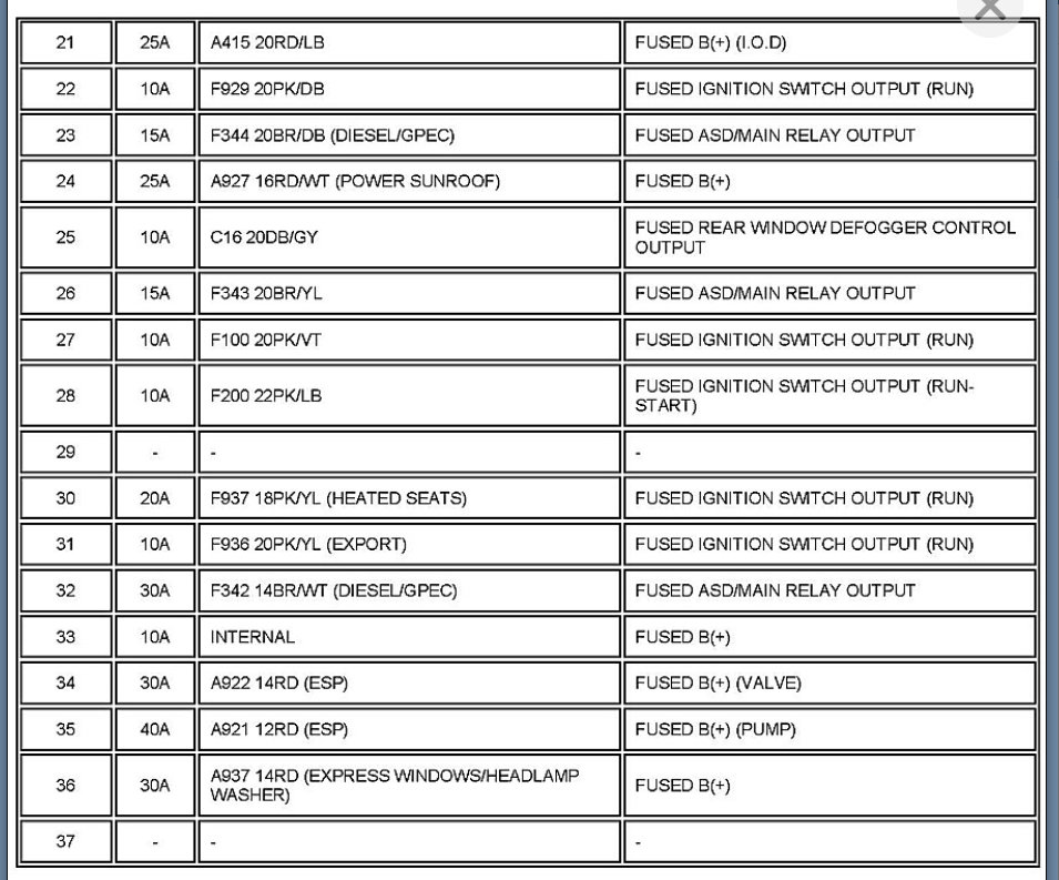

So I need to check the fuses. How can I check?

Went into the ditch and cracked my oil pan on my car. Oil ran out on impact. I think engine shut off on impact. So I need to check the fuses. How can i check?

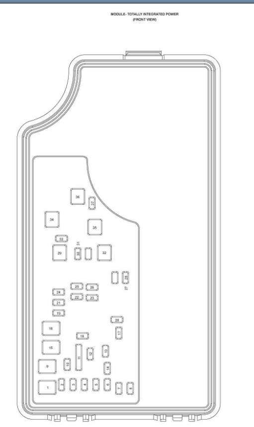

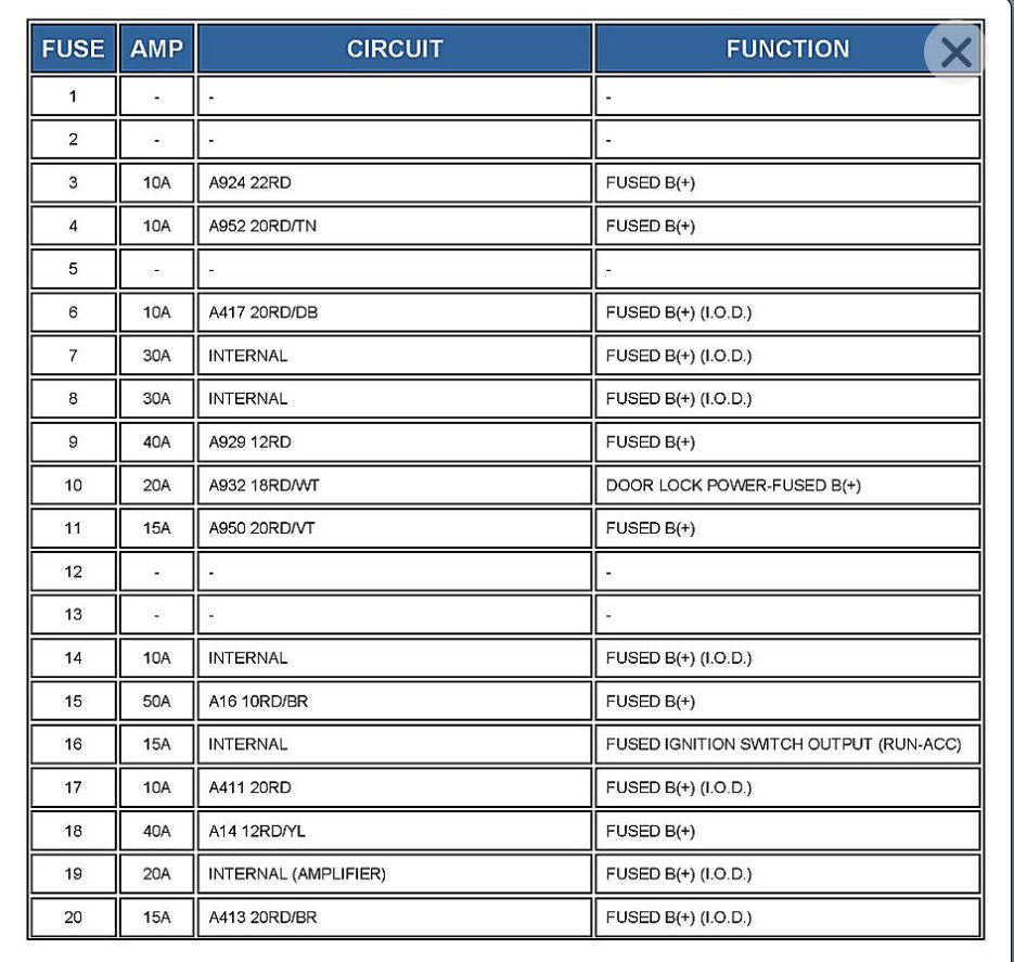

Here is a guide that will help with testing and replacing fuses if you need this:
Below you will find the process from the manual on the location and system for each fuse. Please let us know if you have other questions. Thanks

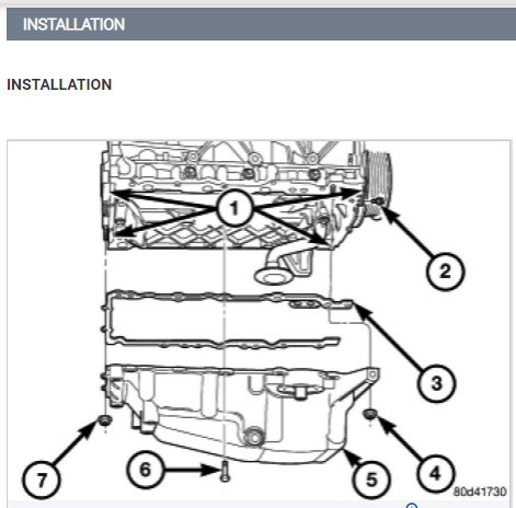

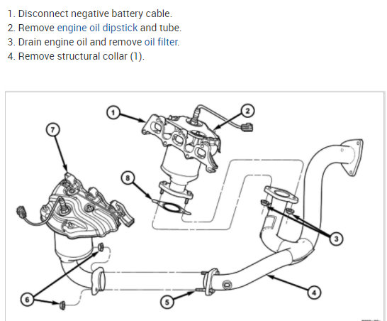

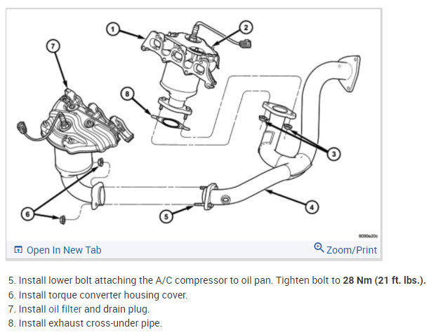

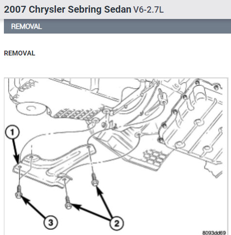

Hello, I'm Danny.

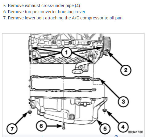

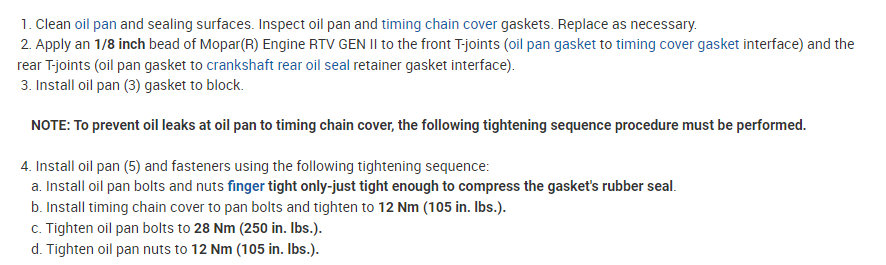

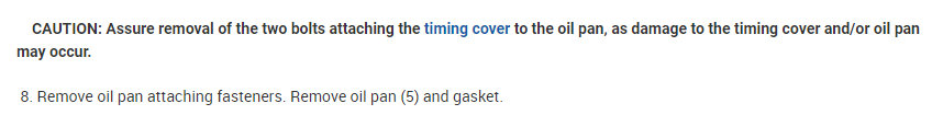

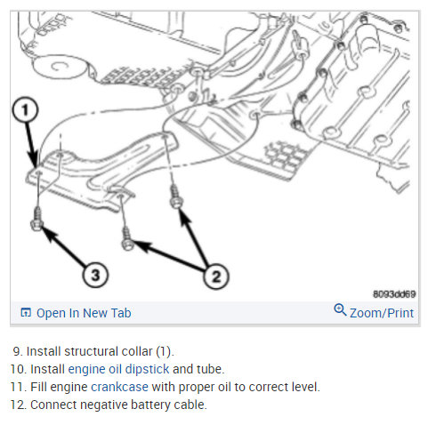

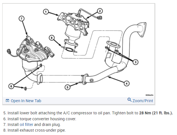

I've attached picture steps below on how to remove and replace the engine oil pan in case you want to complete that repair as well on your car. Hope this helps and thanks for using 2CarPros.
