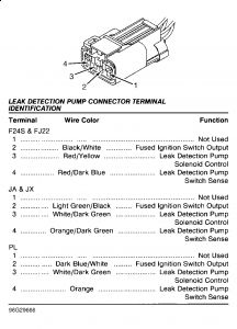

You do have LDP. It is behind right front wheel splash shield. You need to check voltage at the connector, and listen to the solenoid turning on.
And yes, EVAP problem will cause problem after warm up. You won't feel any issue with throttle up, but as you slow down and at idle, you will feel erratic rpm to a point of stalling.
I don't recall you checking vacuum lines. You should do that. Also the EVAP solenoid.
Monday, March 16th, 2009 AT 10:07 PM
ZACKMAN
  • 4,202 POSTS
https://www.2carpros.com/forum/automotive_pictures/55316_97sebringLDP_1.jpg
Sorry, forgot to include the LDP connector to ID. Your body style is FJ22.
Monday, March 16th, 2009 AT 10:10 PM

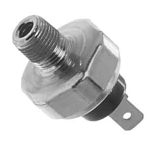

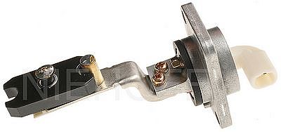

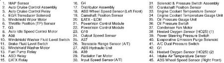

About your oil indicator, it is quite possibly the sending unit is not quite up to par after all these years.
You have both oil level sensor and oil pressure switch. They look like this.
Oil level switch (oil pressure gauge)
https://www.2carpros.com/forum/automotive_pictures/55316_ff30291_1.jpg
Oil pressure switch
https://www.2carpros.com/forum/automotive_pictures/55316_op6697_1.jpg
https://www.2carpros.com/forum/automotive_pictures/55316_97sebringoil1_1.jpg
https://www.2carpros.com/forum/automotive_pictures/55316_97sebringoil2_1.jpg
Wednesday, March 25th, 2009 AT 8:59 PM

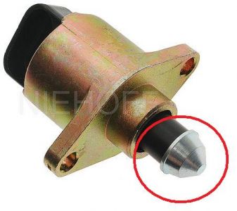

What is the pintle?
Saturday, March 28th, 2009 AT 1:06 PM
ZACKMAN
  • 4,202 POSTS
https://www.2carpros.com/forum/automotive_pictures/55316_97sebringiac_1.jpg
Circled.
Saturday, March 28th, 2009 AT 8:27 PM
