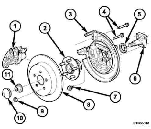

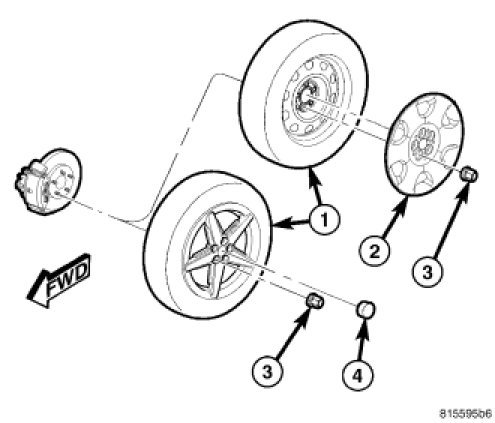

My brakes are grinding in the rear can you help me please?

Here are the directions specific to your vehicle for replacement. The pics below correlate with the directions.
___________________________________________
2007 Chrysler Truck PT Cruiser L4-2.4L VIN B
Removal
Vehicle Brakes and Traction Control Disc Brake System Brake Pad Service and Repair Removal and Replacement Rear Brake Removal
REMOVAL
REMOVAL
NOTE: Refer to Warnings and Cautions.
1. Raise and support the vehicle.
NOTE: Perform STEP 2 through STEP 7 on each side of the vehicle to complete pad set removal.
pic 1
2. Remove the wheel mounting nuts (3), then the tire and wheel assembly (1).

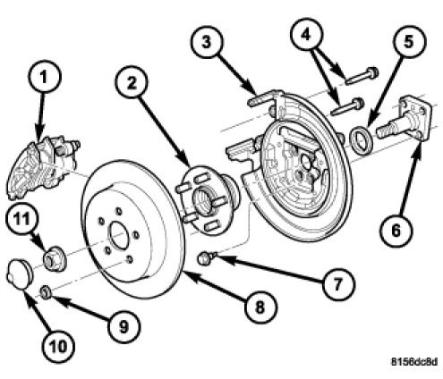

NOTE: In some cases, it may be necessary to retract the caliper piston in its bore a small amount in order to provide sufficient clearance between the pads and the rotor to easily remove the caliper from the knuckle. This can usually be accomplished before the guide pin bolts are removed, by grasping the rear of the caliper and pulling outward working with the guide pins, thus retracting the piston. Never push on the piston directly as it may get damaged.
pic 2

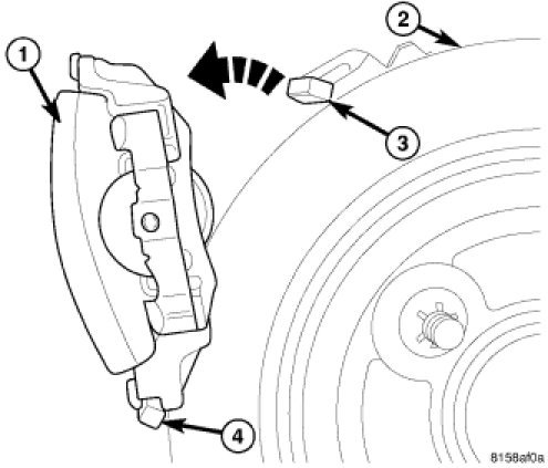

3. Remove the two caliper guide pin bolts (4).
pic 3
4. Remove the caliper assembly (1) from the brake adapter by first rotating the top of the caliper away from the rotor (2), and then lifting the caliper assembly off the lower machined abutment (4) on the adapter.

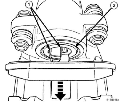

5. Hang the brake caliper from rear strut using wire or cord to prevent the weight of the caliper from damaging the brake hose.
pic 4
6. Remove the outboard brake pad from the caliper by prying the brake pad retaining clip (3) over the raised area on the caliper (1). Slide the brake pad off of the brake caliper.

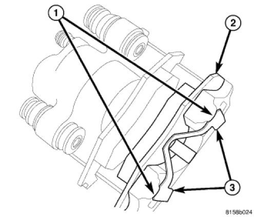

pic 5
7. Pull the inboard brake pad away from caliper piston until the retaining clip (1) is free from the cavity in the piston (2). Remove the pad.
Install is the reverse of removal.

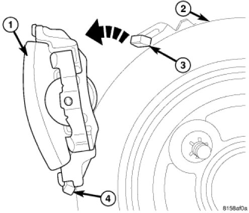

NOTE: In some cases, it may be necessary to retract the caliper piston in its bore a small amount in order to provide sufficient clearance between the pads and the rotor to easily remove the caliper from the knuckle. This can usually be accomplished before the guide pin bolts are removed, by grasping the inboard side of the caliper and pulling outward working with the guide pins, thus retracting the piston. Never push on the piston directly as it may get damaged.
pic 6
pic 7
