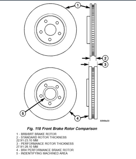

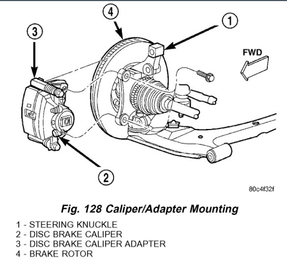

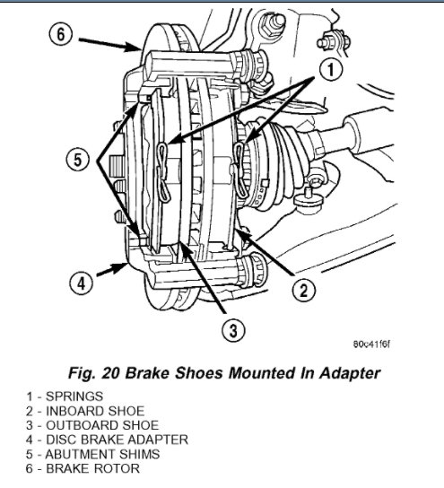

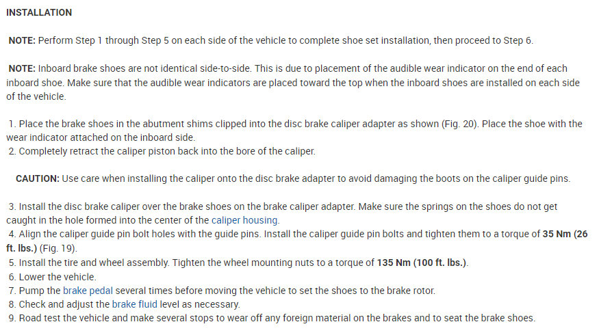

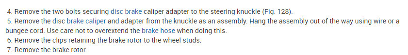

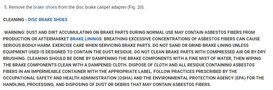

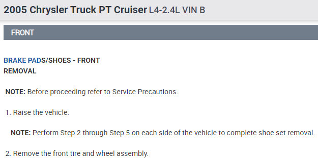

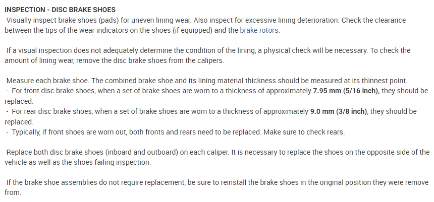

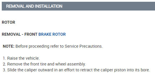

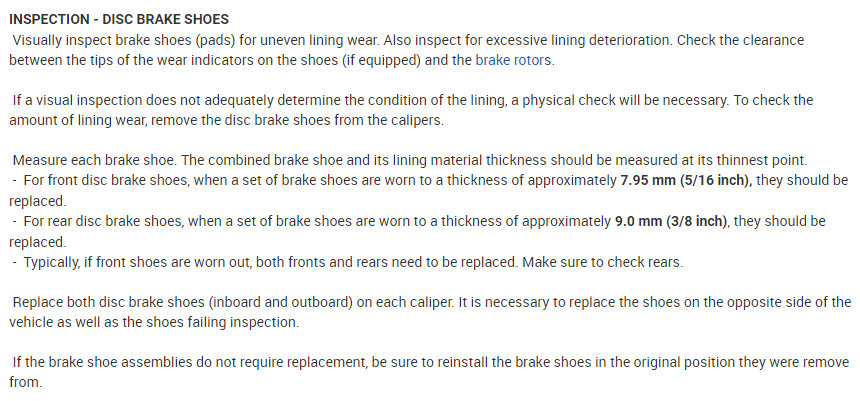

The brake light comes on when the car is in motion (5milesp/h & above) & goes out the the car stops. There is a squeaking noise when the car goes over a dip or bump. Could it be the brake pads are worn, I need to change the brakes.
Dec 3, 2008 at 12:07 AM
DANNY L
  • CAR REPAIR CONTRIBUTOR
  • 5,648 POSTS

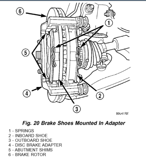

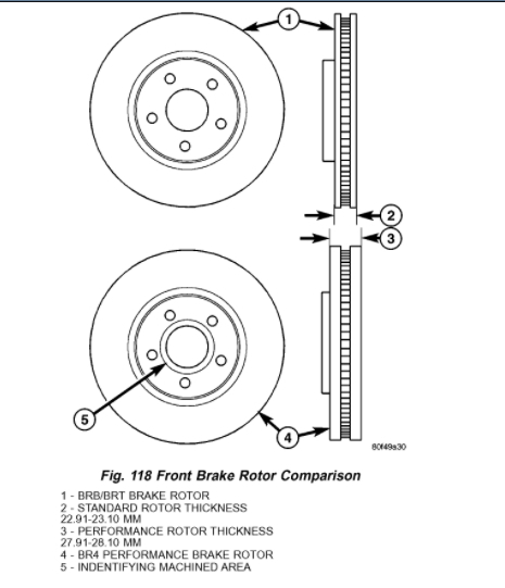

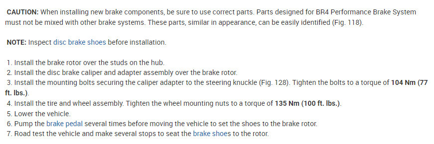

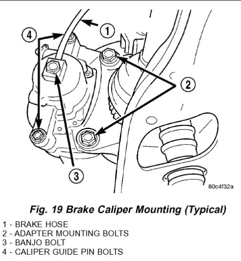

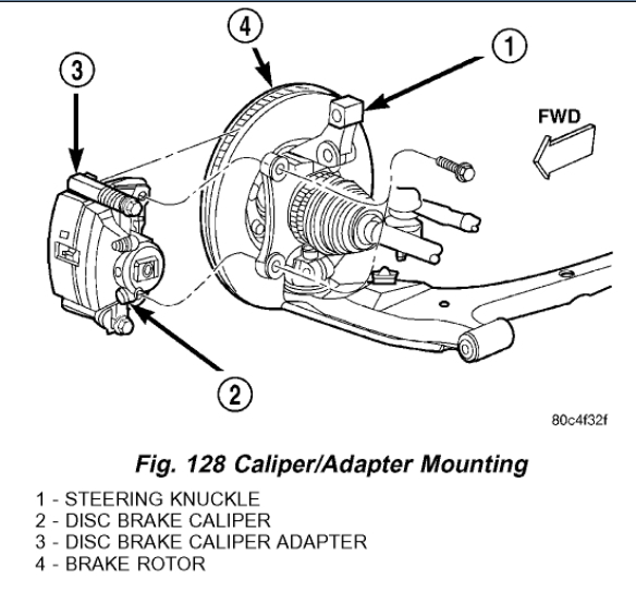

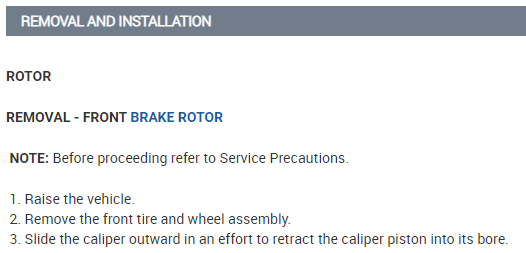

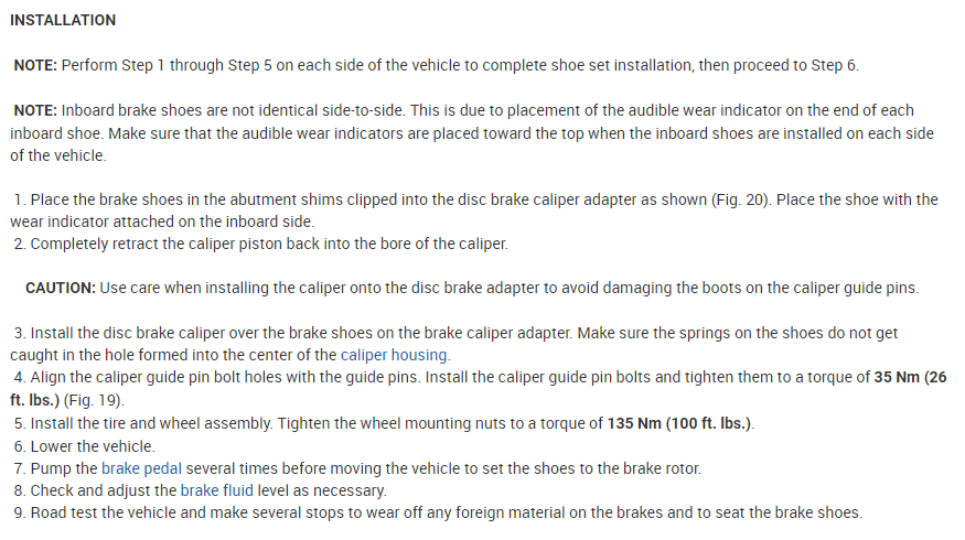

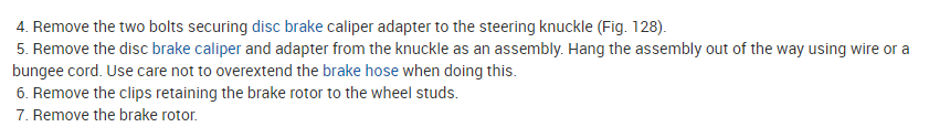

Hello, I'm Danny.
Here is the information you requested. Here is a tutorial showing how to remove and replace brake pads and rotors:
I've attached picture steps below on how to replace the front pads and rotors on your car. Hope this helps and thanks for using 2CarPros.
