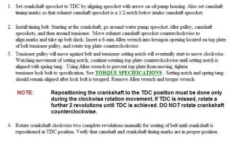

I have a 2002 pt cruiser 2.4 engine. I'm trying to
put a new timing belt on and I have got my cam
shaft gears out of alignment and my crank marks
are off about a 1/4 inch. With the belt on if I turn
the crank shaft until my marks line up on top dead
center on compression stroke. How do I move the
cam shaft gears to line up which should be around
three oclock and the crank should be around twelve
oclock. thanks for your help.
jack
Dec 31, 2009 at 11:28 AM
BLUELIGHTNIN6
  • 16,542 POSTS

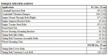

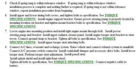

Hello and thanks for the donation! Below are the installing steps for your vehicle's timing belt. Please let me know if you need further assistance..
