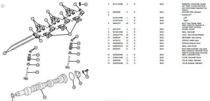

My 2006 Pacifica had valve noize @ 77,000 miles. I had a certified pre-owned warranty (to 80K miles) so the repair was covered less $100 deductible.
From my work order
#1 Customer Reports: TICKING NOISE IN ENGINE
caused by ROCKER AND OIL SHAFT PINS SHEARED OFF CAUSING SHAFT TO ROTATE AND OIL FEEDS NOT SUPPLYING LIFTERS
REPLACED VALVE TRAIN ITEMS.
Labor was 2.60 hrs, a dozen parts, sorry I can't tell you what it would have cost w/o the warranty. I'd guess it would be a minimum of $500.
Oil flows up through this rods on each end of the engine ans swirts out onto the rocker arms. With the pin broken the shaft can rotate and the oil is no longer directed onto the rocker arms. This only happened on one end of the engine but my dealer replaced the rods on both ends
Just today,17 months later @ 104K miles it is making the same type of noise again. That doesn't mean that it is the exact same issue again but I have my suspicions.
Feb 11, 2011 at 3:33 AM
LOWCARB
Follow-up. It was the same failure mode this time also. The pins had sheared off.
Last time, when it was under warranty my mechanic replaced the entire valve train (really it is easier for them that way, especially when someone else is paying for the parts).
This time the saved me some cash by drilling/driving out the broken pins and replacing them. In addition to replacing the pins at the end pedestals the mechanic applies 2 more pins to the Intermediate Pedestals. So perhaps it will be beefed up enough to survive longer. I didn't ask if the holes already existed in the Intermediate Pedestals, or if he had to drill them himself. Perhaps I'll make a call and find out.
