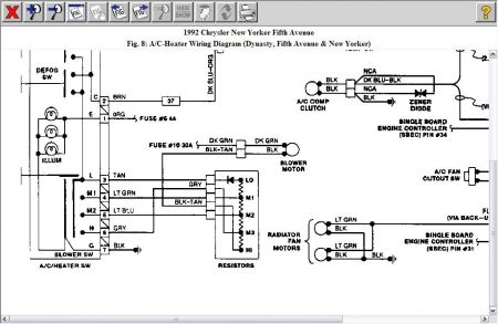

92 Newyorker 130,000miles 3.3l all fuse good, power to the motor, heater control and fan switch replaced, no ground at the motor.
Nov 10, 2007 at 4:19 PM
  • 75,992 POSTS

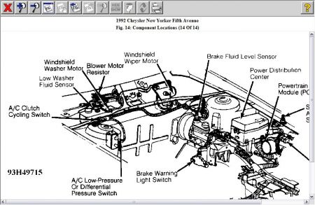

Check the no.10 30amp fuse at fuse box-then check the blower motor resistor see below
https://images.2carpros.com/forum/automotive_pictures/12900_blower_motor_2.jpg
https://images.2carpros.com/forum/automotive_pictures/12900_circuit_1.jpg
