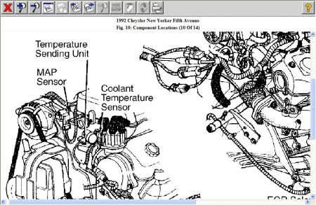

MHPAUTOS
  • 31,937 POSTS
Hi there,
I was sent this pic by another mod i hope it help,
mark (mhpautos)
https://www.2carpros.com/forum/automotive_pictures/61395_12900_temperature_1_1.jpg
+1
Wednesday, July 30th, 2008 AT 6:18 PM
BBEST
  • 8 POSTS
Ok, i'll see what I can do about that.
