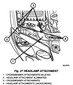

I am trying to replace the Headlight assembly for my LHS due to the retainer clips and studs breaking off.
How do I pull the old, broken assembly out?

Hello The information you requested REMOVAL Headlamp lens fogging is a normal condition and does not require service unless excessive or continual Moisture Will vent from tubes or vents located on the back of the lamp. Release hood latch and open hood. Disconnect and isolate the battery negative cable.
https://images.2carpros.com/forum/automotive_pictures/248015_1_77.jpg
Remove the upper crossmember attachments, both sides, headlamp jackscrews, windshield filler neck screw, and speed control servo screw. Lift and prop the crossmember above the headlamp on the side being serviced, and remove the electrical connectors from the headlamp. Pull headlamp up and under crossmember to remove it from the vehicle. INSTALLATION CAUTION: Do not touch the glass of halogen bulbs with fingers or other possibly oily surface, reduced bulb life will result. NOTE: If replacing complete headlamp unit, transfer halogen bulb to new unit. Put headlamp under crossmember to install it into the vehicle. Install the electrical connectors to the headlamp, and lower the crossmember on the side being serviced. Install the upper crossmember attachments, both sides, headlamp jackscrews, windshield filler neck screw, and speed control servo screw. Connect and the battery negative cable. Verify headlamp operation and alignment. Close hood.
