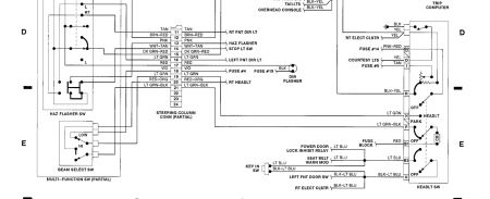

On my LeBaron My headlights wont shut off? The high beam light on the dash always stays on, even when the car is turned off. However the highbeam and lowbeams work just fine. I have to actually unplug my headlights when I shut the car off hahahahaha lol!?!?

The lite green wire at the headlamp switch should not be hot with the switch turned off. If it is hot either shorted to voltage or the switch is bad?
https://images.2carpros.com/forum/automotive_pictures/170934_leBaron_headlamp_switch_1.jpg
