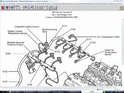

It's mounted in the water jacket near the thermostat housing, thats at the end of the upper radiator hose...it seems Chrysler only uses the ECT Electronic collant temp sensor, your engine is 3.5?
https://images.2carpros.com/forum/automotive_pictures/62217_35_2.jpg
2.7
