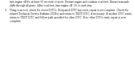

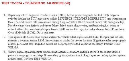

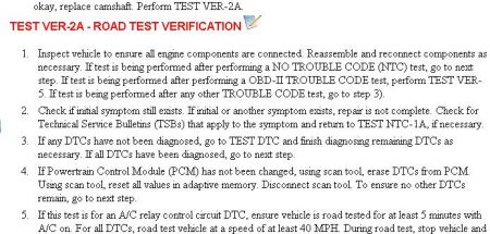

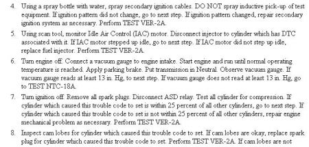

Give the actual code numbers that you receive from the scan tool. In the mean time, here is the diagnostic for engine misfire.
https://www.2carpros.com/forum/automotive_pictures/55316_97concordetc107a_1.jpg
https://www.2carpros.com/forum/automotive_pictures/55316_97concordetc107a2_1.jpg
https://www.2carpros.com/forum/automotive_pictures/55316_97concordetc107a3_1.jpg
https://www.2carpros.com/forum/automotive_pictures/55316_97concordetc107a4_1.jpg

The diagnostic works for P0300 through P0306. I kind of figured the code was P0305, for cylinder 5. So perform the diagnostic, concentrating on cylinder 5.

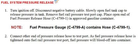

I want to replace the fuel filter on my own. Will removing the fuel cap be enough to release the fuel pressure so I can replace the filter?
Wednesday, March 11th, 2009 AT 5:33 PM
ZACKMAN
  • 4,202 POSTS
Gas cap removal is OK to release the tank pressure but not enough to remove the pressure in the line. Here is the instruction.
