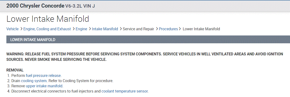

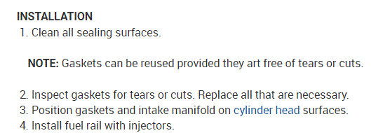

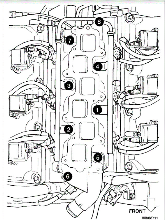

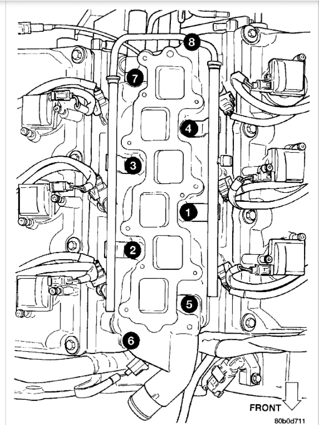

I'm burning oil white smoke is coming out the exhaust. What causes that? head gasket replacement instructions please?
Mar 31, 2009 at 5:49 AM
  • 110,240 POSTS

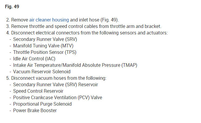

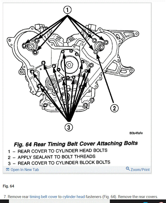

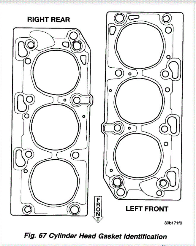

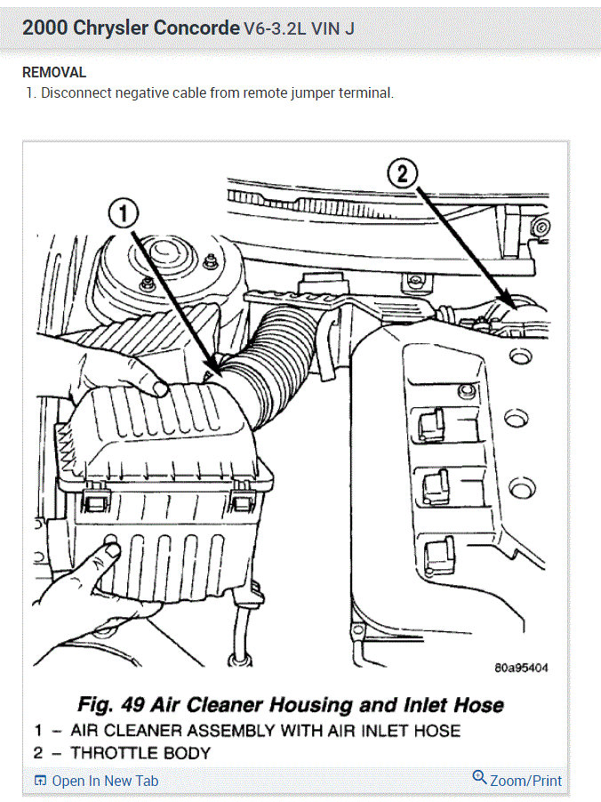

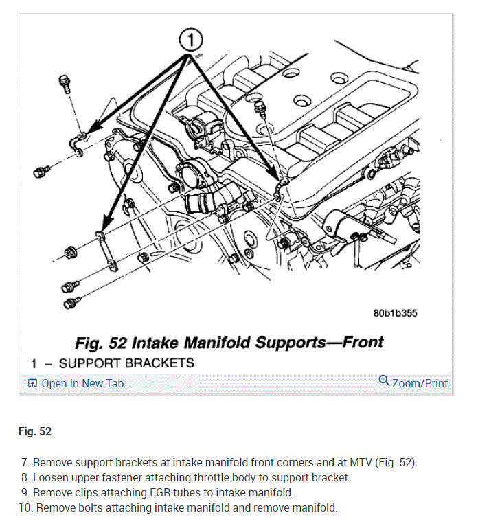

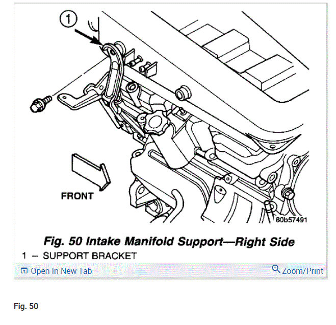

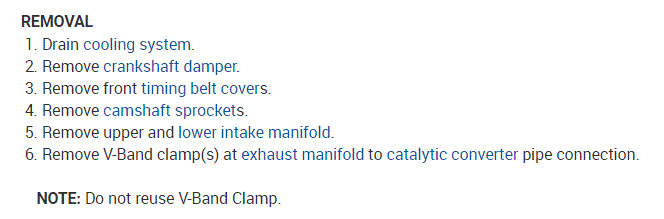

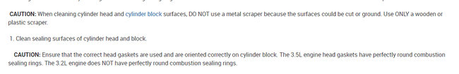

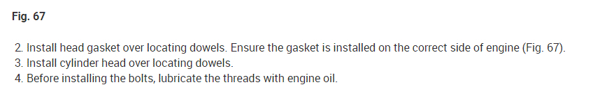

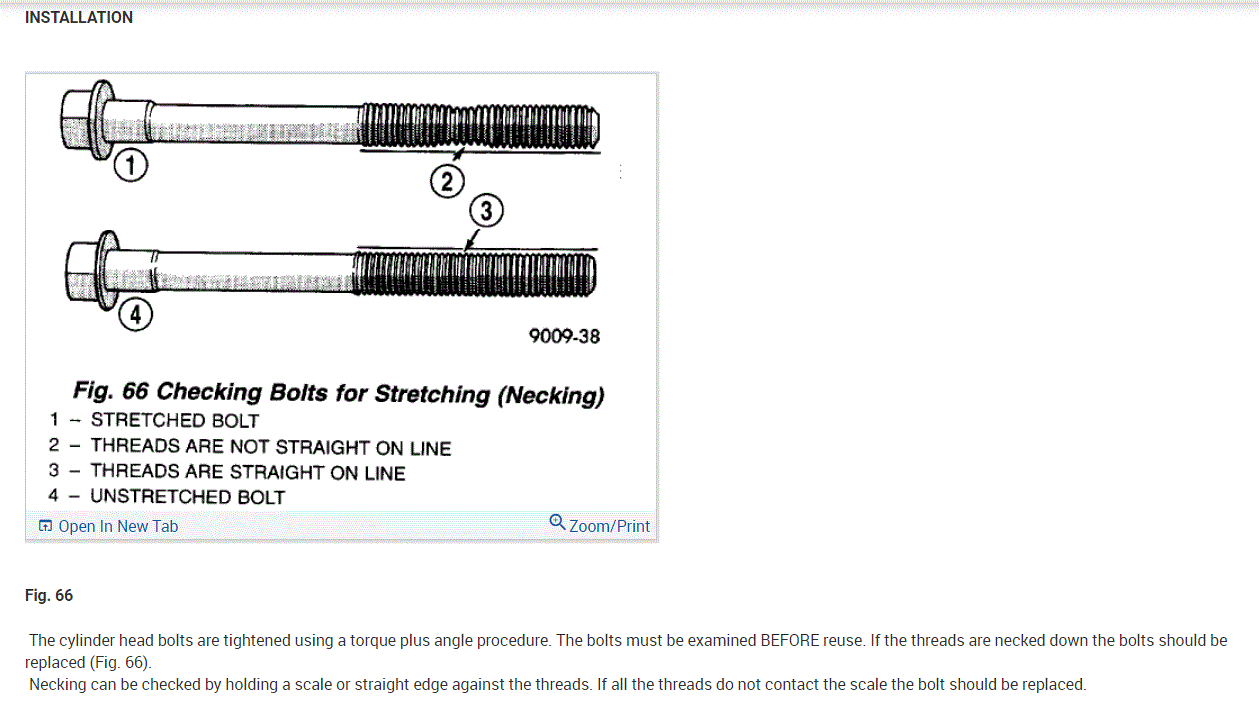

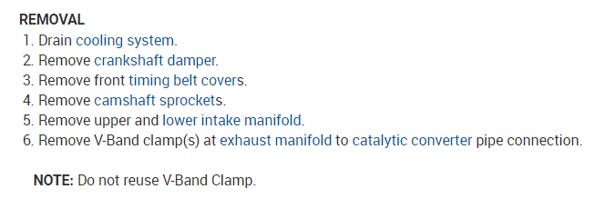

The most common cause of excessive white smoke from the exhaust is engine coolant entering the combustion chamber. The cause is likely related to a failed head gasket.
Take a look through this link first:

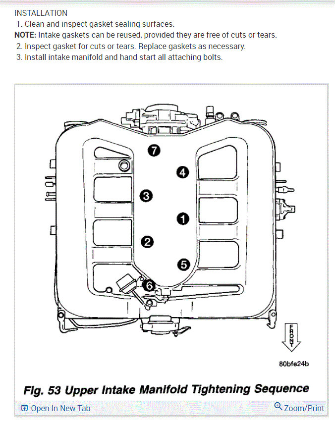

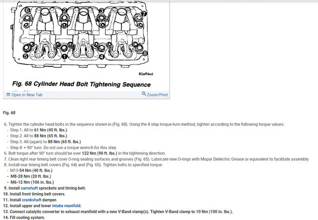

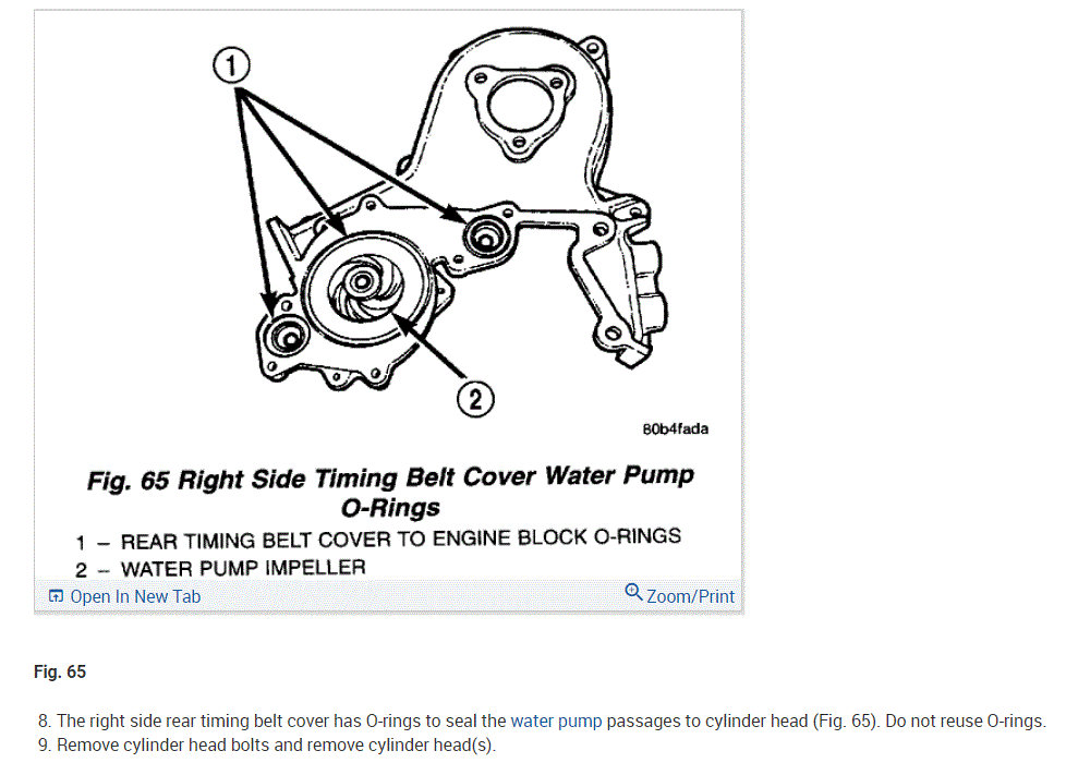

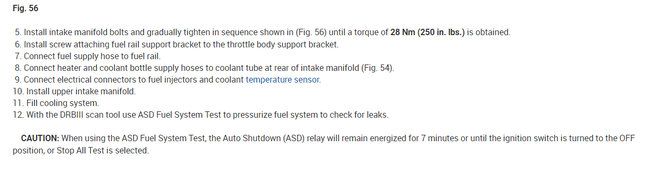

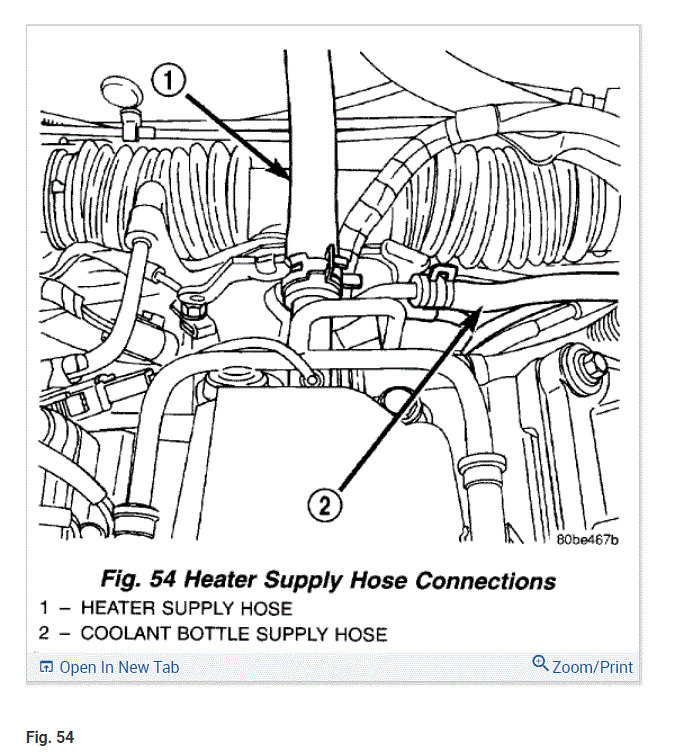

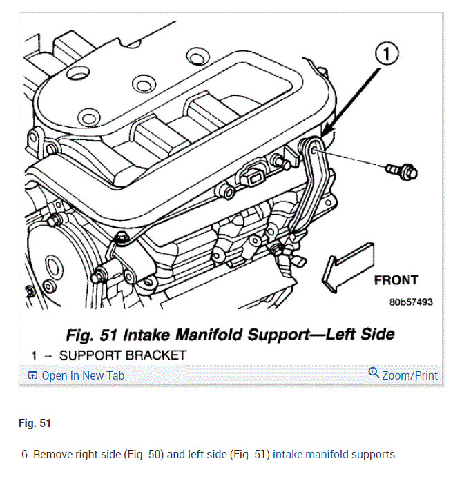

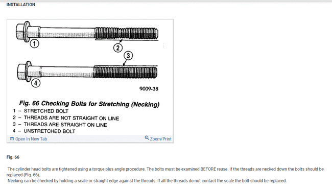

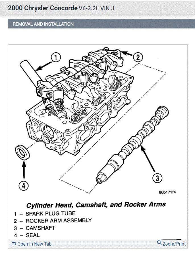

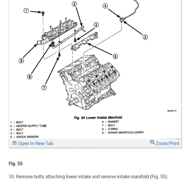

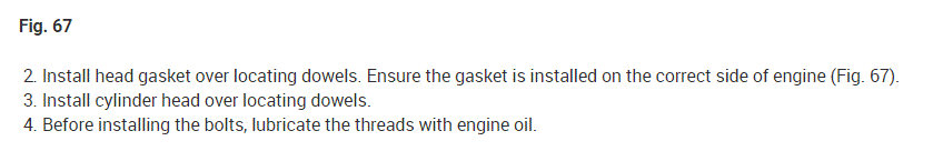

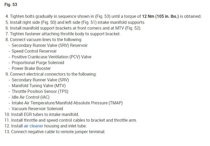

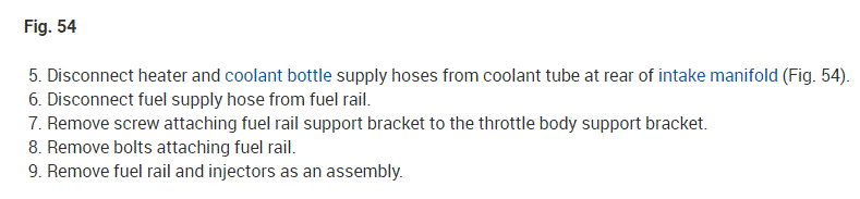

If you find the head gasket is bad, below I attached the directions for the removal and replacement of the cylinder heads. You will first need to remove the valve covers and intake manifold. I included the directions for that as well.
