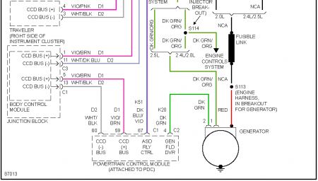

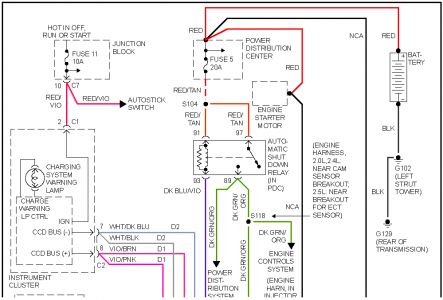

MERLIN2021
  • 17,250 POSTS
Heres the system diagram, see if connections are right.
https://images.2carpros.com/forum/automotive_pictures/62217_cirrusa_1.jpg
https://images.2carpros.com/forum/automotive_pictures/62217_cirrusb_1.jpg
Mar 2, 2009 at 7:37 AM
STARDOLL2000
Thanks for the lay out..already had one of those..came with the car. However we found the problem..the amp was turned off but it was still drawing power..so we took it apart and out of the trunk. All is fine..and hooked amp back up. so the car is rolling..I knew it was not the battery or alternator. Thanks for trying anyway to help me.
