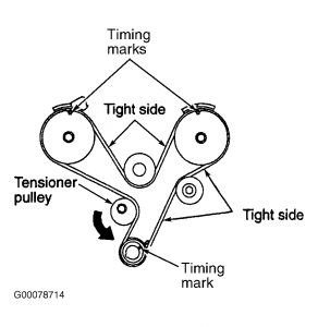

how do u pull a water pump off and reinstall

Water pump is driven by the timing belt
once timing belt removed
remove water pump mounting bolts
separate W/P from water inlet pipe and remove
make sure you inspect the pipe before new W/P installation
good luck
https://www.2carpros.com/forum/automotive_pictures/99387_ciruis_1.jpg
