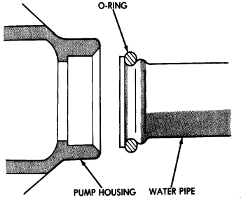

How do I replace the water pump

1.Clean all gasket and O-ring surfaces on pump and water pipe inlet tube.
Water Pipe O-Ring
https://www.2carpros.com/forum/automotive_pictures/12900_cwp3_1.gif
2.Install new O-ring on water inlet pipe. Wet the O-ring with water to facilitate assembly. CAUTION: Keep the O-ring free of oil or grease.
3.Install new gasket on water pump and install pump inlet opening over water pipe, press assembly to cause water pipe insertion into pump housing.
