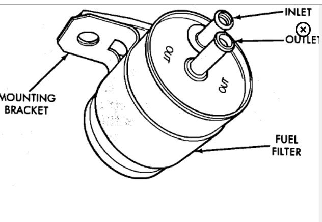

Chrysler New Yorker Fifth Avenue 3.3 V-6
Where is the fuel filter located?
May 7, 2007 at 11:27 AM
Experienced Mechanic
55,688 POSTS
The fuel filter is located near the gas tank between the frame and the rear suspension. You will need to jack the car up to change it.
and
https://www.2carpros.com/articles/how-to-change-a-fuel-filter
This guide will give you the idea on what to do.
Here is a diagram of what it looks like.
Best, Ken
