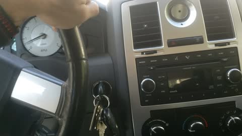

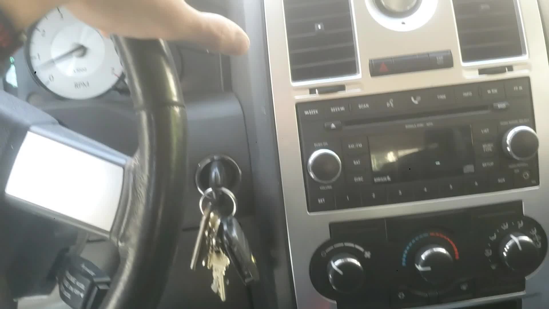

My car has a rattle knocking grinding sound (Video is attached) and it is noticeable at idle or when driving. I don't really hear anything when the car is actually in parked mode or if so, then there is a much softer sound.
I started hearing this once the transmission oil was changed. So as a result, it was changed to a second time about a month later with about an extra 750 miles on it and with a bottle of Lucas Transmission fix.
I still hear the same rattle noise. I have worked on cars before, but I do not want to remove the transmission from the car if that is a potential problem.
Any ideas on how to fix it?
Or any ideas on how to mask that noise?
Also, would it be helpful to do a gear oil change? as this car has never had one. Could that be affecting the noise of the transmission?
Please let me know.
Thank you so much!

I do hear it. This started after someone serviced the transmission. As far as the noise, I have a few questions.
First, does it change with speed so that the faster you drive, the faster the noise? Or does it speed up when you rev the engine?
Keep in mind, this could be coming from something different. Are you sure that sound is from the transmission? Was there any change when you had the fluid changed the second time?
Let me know. Also, let me know if it is louder at any point on the vehicle.

The sound you hear from the clip attachment is still the same today. The sound does NOT get louder the faster I drive, nor does it get louder when I rev the engine. It actually gets softer and is noticeable in stop and go driving or in idle with the car in drive or reverse. Also, it has a much fainter sound when driving on expressway driving at least over 40 MPH.

I haven't heard one like that in the past. However, listening to it on a computer may be changing it to an extent. Is the video you sent providing an accurate representation of the noise? Do you feel any vibration in the floor, pedals, steering, or anything that feels like it could be related?
