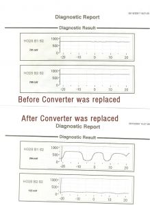

SERVICE WRITER
  • 9,123 POSTS
https://images.2carpros.com/forum/automotive_pictures/30961_o2_waves_4.jpg
The bottom pic is how the waves should look. I think I would stay on the path of the O2 circuit before getting into a computer. Maybe run the car up in the air and monitor the wave pattern, while someone wiggles the harness to see if you can make the pattern change. Maybe tap on the sensor and look for a response. Maybe a defective sensor.
