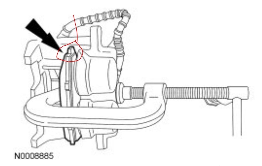

There’s a chirping noise when I accelerate and it sounds like it’s coming from the drivers side under the hood or possibly by the wheel well. There’s a similar noise when I brake as well but it’s a little louder than when I’m accelerating. Also, the rotors and brake pads have been replaced about a few months ago on the front end.

This sounds like the front pads are making noise. It could either be from they are worn down and the warner tab is rubbing the rotor or the pad material is making the noise.
What kind of pads did you use for the replacement?

4. NOTE: Install new brake pads if they are worn past the specified thickness above the metal backing plates.
Remove the brake pads and discard the 4 spring clips.

1. NOTICE: Protect the piston and boots when pushing the caliper piston into the caliper piston bores or damage to the piston or boots may occur.
If installing new brake pads, using a C-clamp and a worn brake pad, compress the brake caliper pistons into the caliper.
2. NOTE: Install all the hardware supplied with the brake pad kits. For vehicles equipped with an 8 cylinder engine, install the brake pad shims (2 shims for each pad/slotted shim first) and apply a thin coat of the supplied lubricant between the 2 shims.
Install 4 new spring clips and the 2 brake pads.
3. Position the brake caliper on the anchor plate and install 2 new guide pin bolts.
Tighten to 34 Nm (25 lb-ft).
