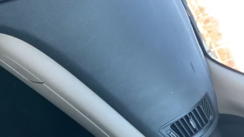

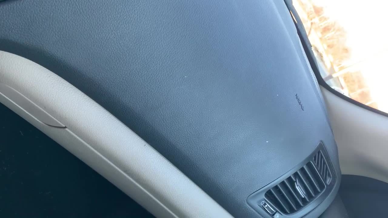

Hey Joe! Thanks for responding to my inquiry. So I didn’t do quite what you asked, but I did take a video of it in drive, park and lastly reverse. You can kind of hear how the noise shifts a little differently between gears. Hopefully this helps? Please let me know if I can record anything else. I figured to grab this video while I was driving, as I’d remembered your response and wanted to get it while it was happening.

I listened to the video. I'm not able to hear a chirping sound. Are you able to try the test I suggested?
