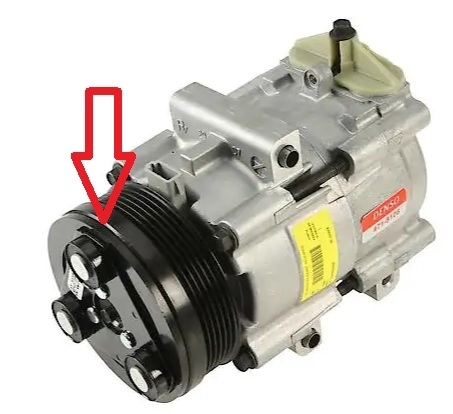

Maybe the inner clutch portion of the A/C compressor is slightly dragging its pulley when it is not engaged?
I feel sure you have disregarded or eliminated the A/C clutch kicking in and out when the A/C is called on to run in the "A/C" and any heat positions with "Defrost" as making the racket?
Keep us posted.

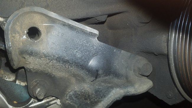

Hello, just thought I would give you an update. I droped my truck back off at my mechanic because the sound was intensifying and he just started taking things apart trying to see what was making the noise and finally found something. It had nothing to do with the belt and nothing to do with the pulleys. He saw a piece of metal moving on a plate that bolts into the power steering pump and discovered there was this huge bolt missing out of it. He put something in the hole and the sound immediately stopped he took it back out and the sound started back up he put it back in and the sound immediately stopped again. The shop that had replaced my power steering pump and water pump this past February forgot to put the bolt back in because as you can see in the picture there is grime covering the area where the bolt would be as well as inside of it. The reason the sound went away when I sprayed the belt is I was spraying in the exact area of this plate. This has pretty much been a nightmare for both of us and we are all very relieved that this has been fixed. Thank you again for your help, and merry Christmas!
