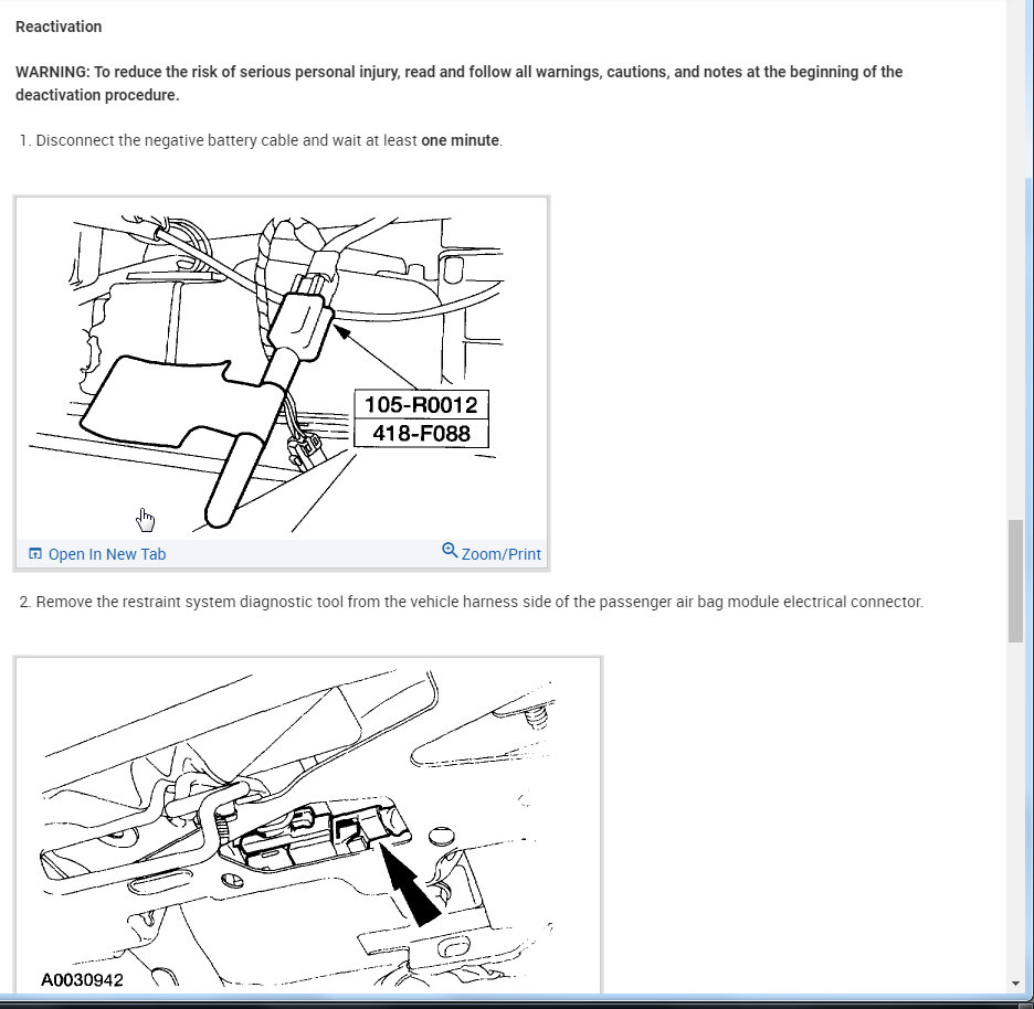

How do you disarm or remove SRS chime behind dash? where is it located?
Dec 9, 2019 at 1:57 AM

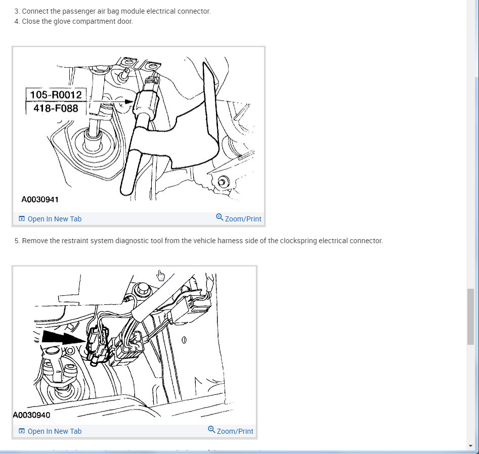

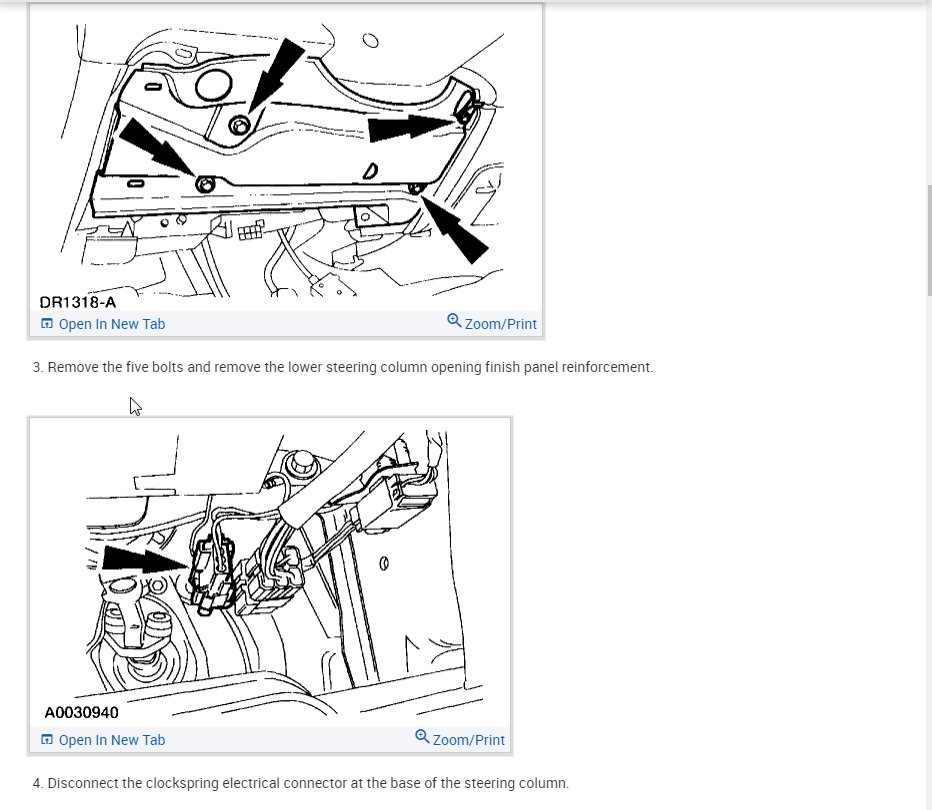

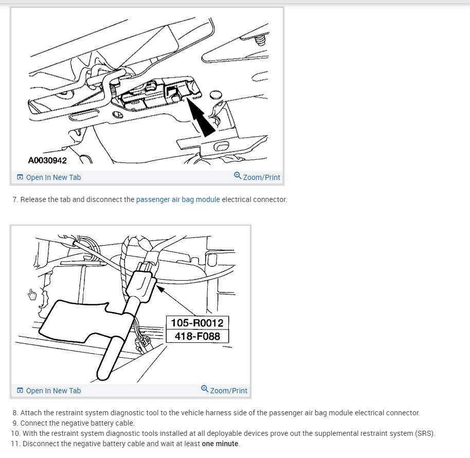

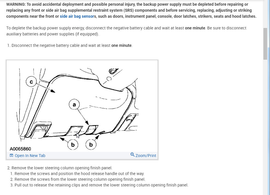

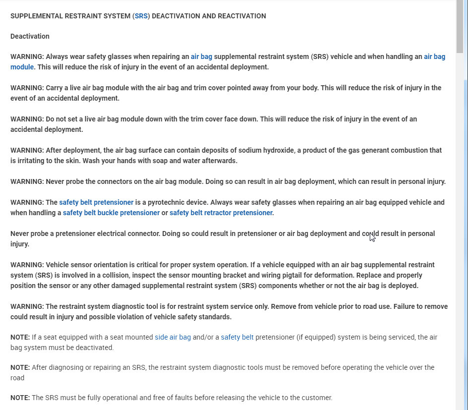

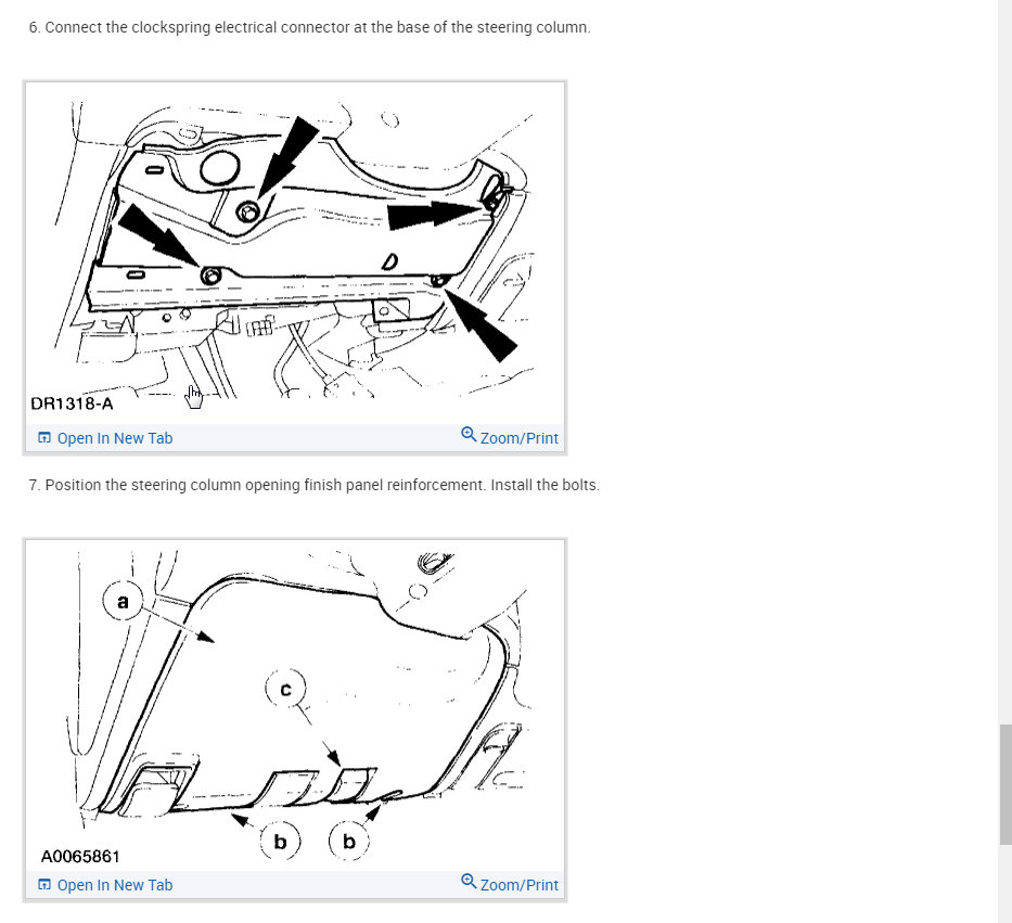

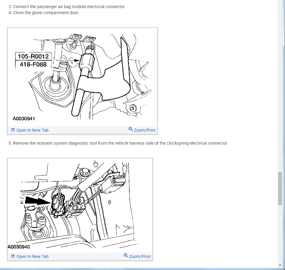

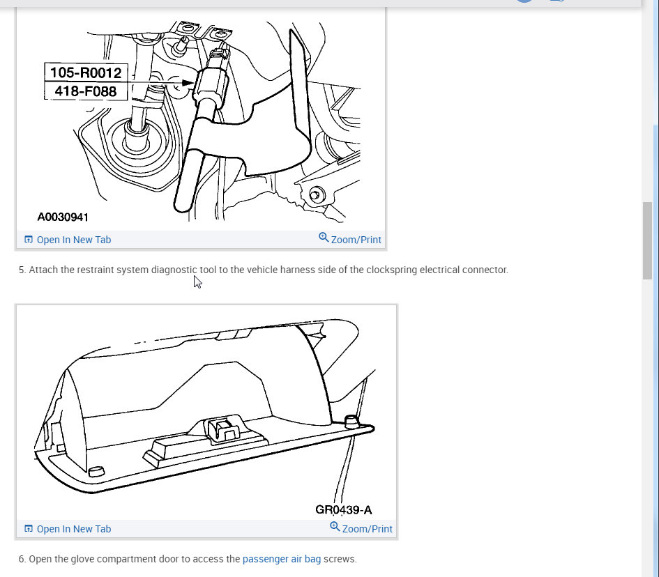

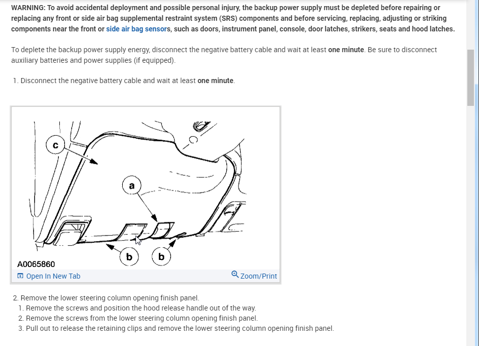

Unfortunately it is not legal to disable the restraint system so we can't advice you how to disable the light. In fact the only way to disable it is to diagnose it and fix it. So let's use the attached process on how to diagnose it. This is going to require tools called an airbag simulator which basically takes the place of the airbag. If when these are hooked up and the light is off, then the airbag is the issue. If this does not cause the light to go off then there is another issue.
Let me know what you find. Thanks
