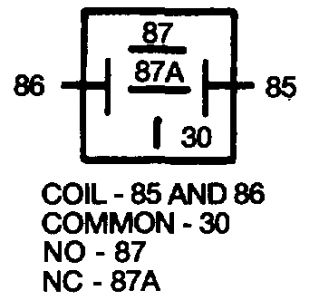

The PCM power relay is in the engine compartment fuse/relay box Testing and Inspection Note
https://images.2carpros.com/forum/automotive_pictures/12900_pic1_1.jpg
If the circuit is open, the engine will not start. If the circuit is shorted, the EEC PWR fuse (30A) will burn out. Inspection Measure resistance between pins 85 and 86 of the relay.
https://images.2carpros.com/forum/automotive_pictures/12900_pic2_1.jpg
Specification: 40-120 Ohms. Measure resistance between pin 85 and both pins 30 and 87 of relay. Specification: greater than 10,000 Ohms. Apply battery voltage (B+) and check for continuity between terminals of the relay. If not as specified, replace the PCM power relay. The computer grounds the PCM power relay coil side this don't happen other areas will be affected
