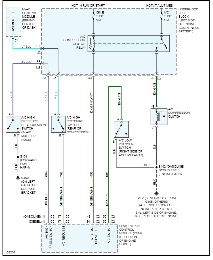

Hello! I have the truck listed above 1500 with a 5 speed. I recently replaced my compressor and condenser, and I am still having cooling issues. Compressor runs when jumped at the relay. All sensors are bypassed. Freon is adequate.
Probing AC Relay pin 85 shows an Intermittent Ground from the PCM. It works when i drive down the highway. It works when i first crank the engine. But when i put the truck in gear and roll it, the ground immediately goes away. Then the compressor will kick on, drop RPMs, then immediately kick off. Over and over.
With the multimeter on my hood, I can watch the GND come in and out from pin 85

It sounds like the PCM, or the HVAC controller is bad, you might what to do a CAN scan to see what codes come up. You can get a CAN scanner (Controller Area Network) which will work on most cars from Amazon.
here is a video to show you how:
https://youtu.be/u-4syLc-ifQ
Here are the AC system and compressor wiring diagrams so you can see how the system works. Check out the images (below). Please let us know what happens.

So, I cleaned out the ground on the harness below the alternator - using your diagram. It seemed to help! I reset the PCM by disconnecting the battery and grounding the power cable. I tested resistance from AC relay pin 85 and pin 43 on red connector of PCM. Sat 0 ohms. Cleaned out dust from the back of the PCM connectors.
