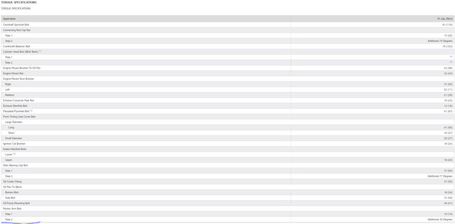

Six cylinder front wheel drive automatic 170,000 miles.
I am looking for the torque specs on my car. All the manuals are only showing specs up to a 2000 model. My book is a 1999 through 2005. I want to get this accurate I just replaced all the engine gaskets do to a blown head gasket and I used the new replacement kit. Please let me know ASAP. I am down to this step. Thank you.

Here is the torque specs for the rocker arm and a video on how to use a torque wrench.
Rocker Arm Ratio 1.60:1
Valve Rocker Arm Bolts
First Pass 32 Nm 24 lb ft.

Rocker arm torque specifications please.
Dec 5, 2020 at 1:42 AM (Merged)
RYAN L
  • 272 POSTS
Check out the picture the torque information is in there! Thank you so much for using 2CarPros! If you need anything else please let us know!
