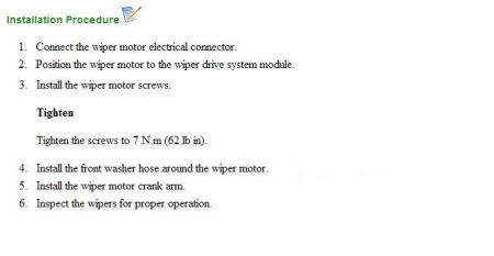

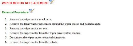

The problem I have is that the front windshield wipers aren't returning to the bottom when the switch is in park. The wipers work properly otherwise! It's my understanding that this is a common thing on this vehicle.How can I fix this problem? I was told I have to replace the wiper motor, is the wiper motor the culprit? Is there another possability? thank you Paul84

https://images.2carpros.com/forum/automotive_pictures/261618_Noname_1421.jpg
https://images.2carpros.com/forum/automotive_pictures/261618_Noname2_419.jpg
