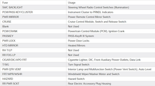

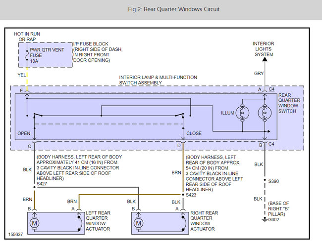

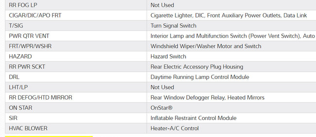

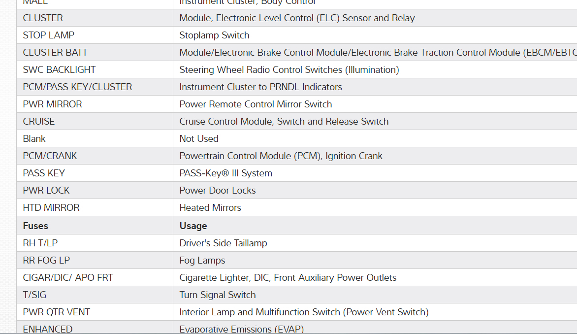

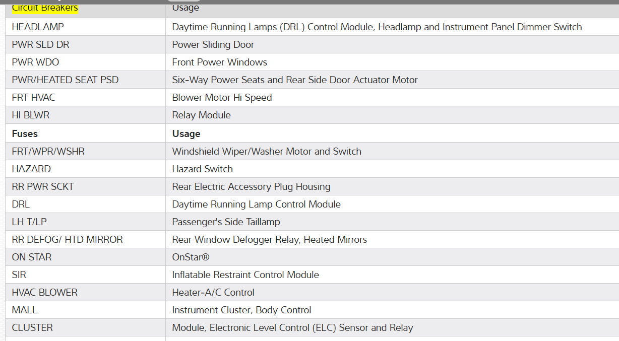

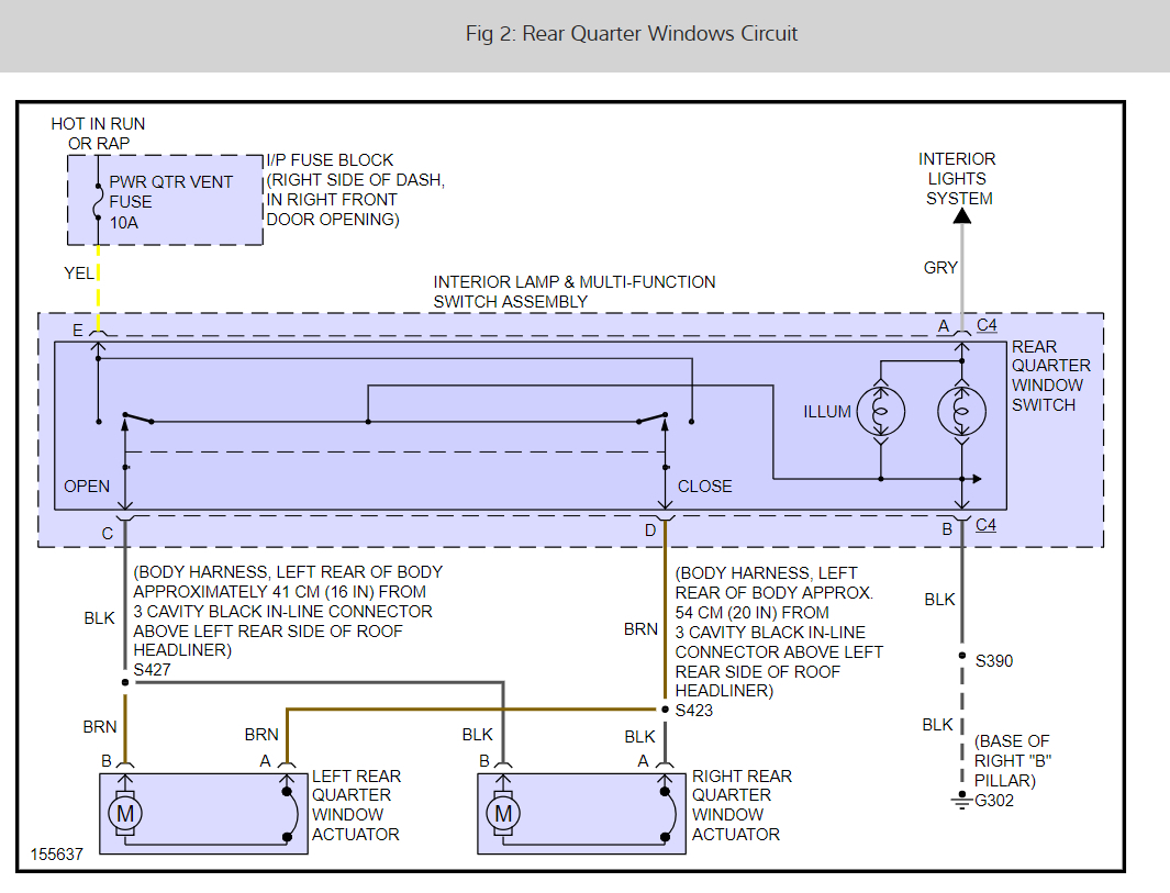

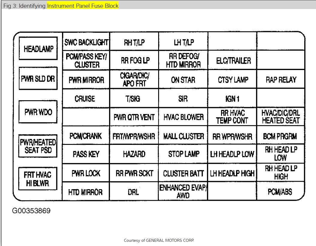

I have a 2002 Venture (3.4L) with 60K miles. The power rear quarter windows do not open when I hit the switch on the overhead console. The owner's manual does not indicate which circuit breaker/fuse controls this function. I don't know if it's a bad switch or a bad fuse. Any ideas? Thanks for the help.
Apr 24, 2007 at 11:35 PM
ROCKWOOD84
  • 103 POSTS

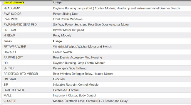

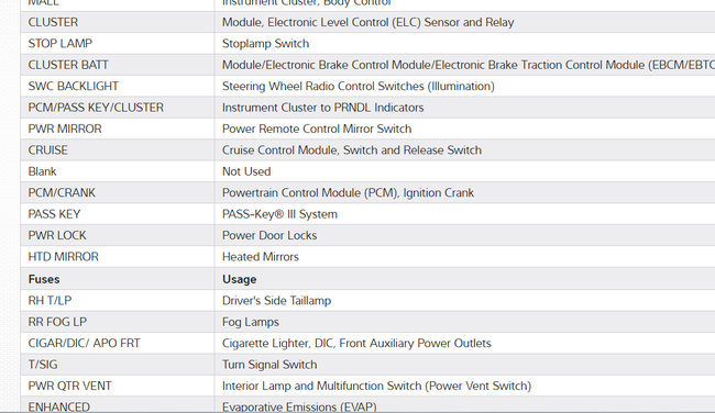

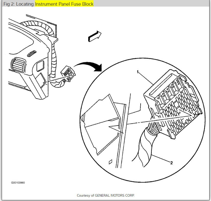

There is a fuse on the right side of the dash that needs to be changed here is the wiring diagrams so you can see how it works and the fuse location with a guide to help you check it.

Thank you this fixed my car, I love this site.

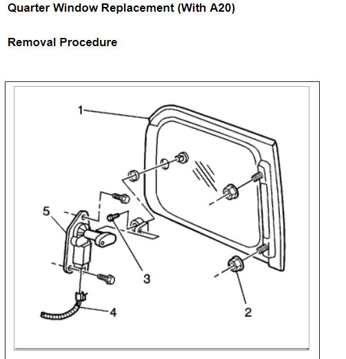

I can not get the rear windows to close. When I press the button I dont even hear the motor running. Is there a way to close them manually or do I have to get the motor replaced?
Nov 16, 2018 at 1:01 PM (Merged)
  • 110,194 POSTS
There is no way to close them manually. It sounds like the motor went out which are not to bad to change hear is a diagrams to show you how
Check that and let me know what you find.
