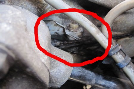

I have a coolant leak and after feeling around and a couple heat warnings on the arm and hand from the exhaust while feeling and checking hoses, I think I have spotted the location of the leak.
Looking in from the front of the van, looking under the throttle body, under the aluminum thing on the top of the engine (upper plenum?) I can see the head of a bolt and it looks like the coolant is coming from that area. (hard to tell in that small space there is to look in)
If that is where the leak is what is there that would be leaking?
red arrow pointing the direction I am looking to see water bubbling.

It could be the Thermostat Housing Gasket. Does it look like it somewhere at the end of the Radiator Hose that connects to the Housing?
Can you get a close up pic in that area?

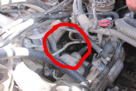

it was a challenge...lol but here is the best I could get(dark out). Looking right in there. There is a bolt head, cant really see it in the picture. The bolt head is below and back a wee bit of the throttle body (towards firewall)

Ok, from what I can see and of course it's not much there are 2 possibilities....
One is the Intake Gasket - I say this cause you said about the bubbling at the bolt head.
The other could be just a leaking Throttle Body cooling hose that is dripping in that area.

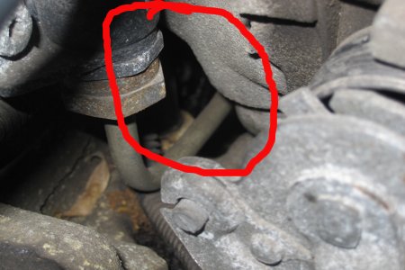

Ok we removed the throttle body and the aluminum part that was attached to get a better look. The first image is not as close as the second to give an idea of what you are looking at in the close picture. In the close up, just a bit to the right of the bolt is where we found the leak to be. We sealed all the lines and hooked a bicycle pump to the line and pumped some air in and that is where water/coolant came out. Is this a big job to fix? Is it costly? Would there be a chance that stop leak stuff might seal it?

Ok, it can be a big job depending on how mechanically inclined you are. Cause it looks like it is the Intake Gasket.
I did look at my wifes van and that bolt is the only thing I could see that would be leaking.
Anyway, yes you can try some stop leak and see what happens. But that is usually just a temp fix, especially with the Intake Gasket. And since you have it apart somewhat already I would continue on.

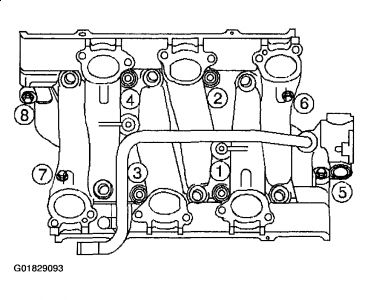

Sorry took so long I'm sure if you were going to attempt the repair it is probably already done. But, if not here are the Torq Specs Lower Intake 1st - Verticle Bolts = 62 inch pounds 1st - Diagnal Bolts = 62 inch pounds 2nd - Verticle Bolts = 115 inch pounds 2nd - Diagnal Bolts = 18 Foot Pound Upper Intake 18 foot pounds Here is the tightening sequence for the lower intake...
https://images.2carpros.com/forum/automotive_pictures/188069_02venture_lowerintakeseq_1.jpg
And I guess it doesn't matter with the upper cause I cannot find the tightening sequence. However, I would start with the center bolts and work out in an X type pattern... 5__________________1__________________3 4__________________2__________________6 .
