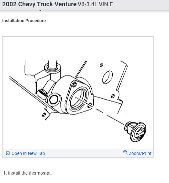

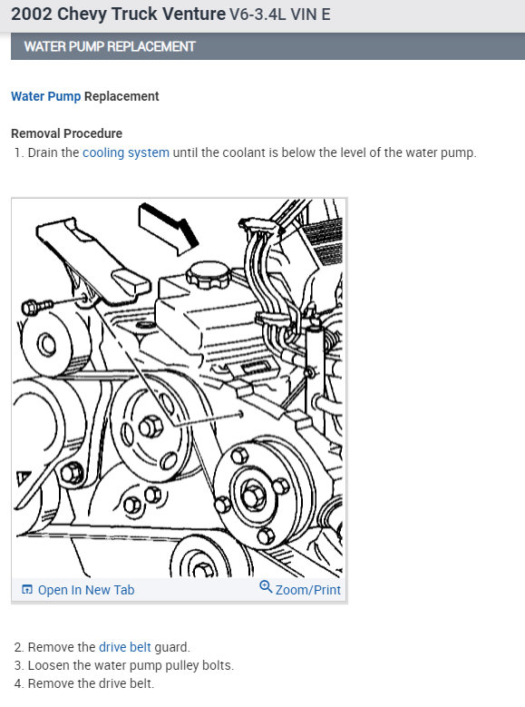

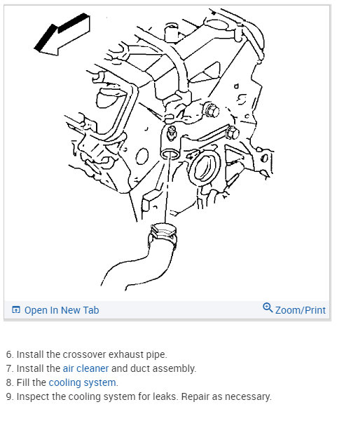

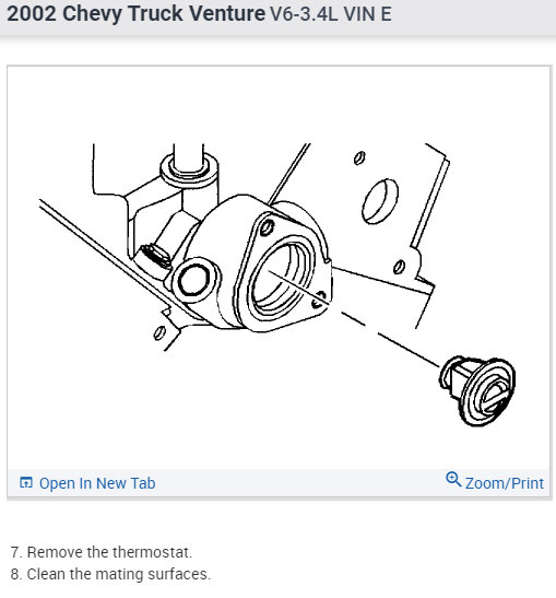

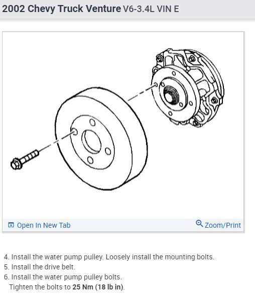

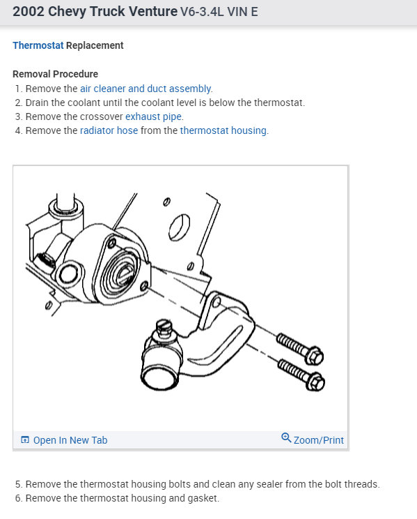

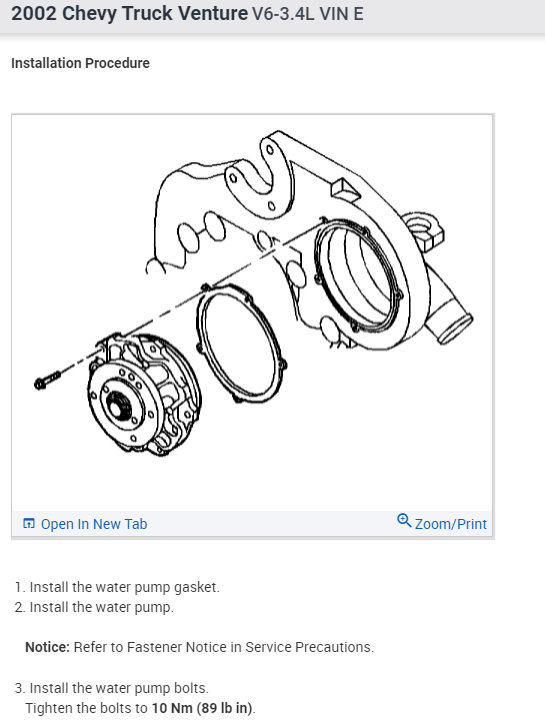

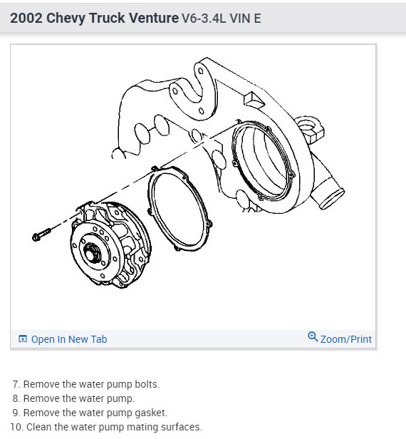

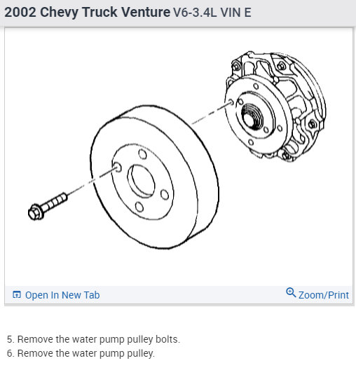

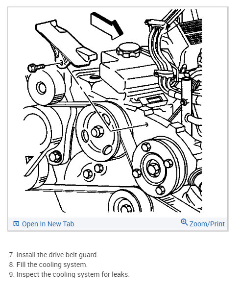

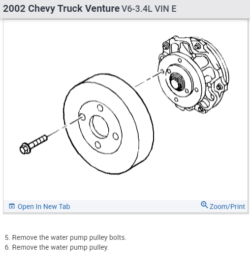

Coolant can leak from a number of places. Hoses, radiator, water pump, heater core.
Best course of action is to do a thorough inspection including looking under the vehicle to deter mine where is a leak might be coming from.

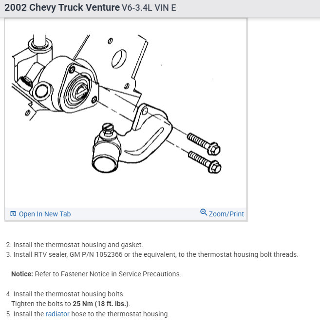

If the leak is from the side the belt is located, then it could be the water pump. Keep in mind that it can also be the thermostat housing.
Here is a helpful guide:
https://www.2carpros.com/articles/coolant-leak-symptoms
