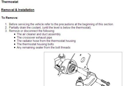

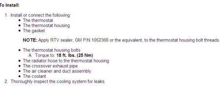

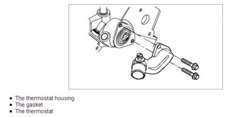

How to replace it

+1
Wednesday, April 8th, 2009 AT 1:01 PM
