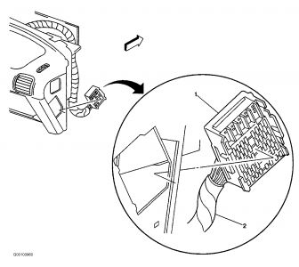

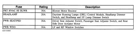

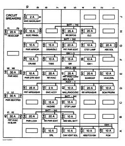

1998 chevy ventures dash board and running lights stopped working(break lights, turn signals still work) I think it is a fuse in the fuse box on the engine block but I need to know which one and where it is in the box. Or if you think it can be anything else please respond
Thank you
Thursday, October 28th, 2010 AT 5:40 AM
BMRFIXIT
  • 19,053 POSTS

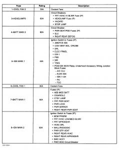

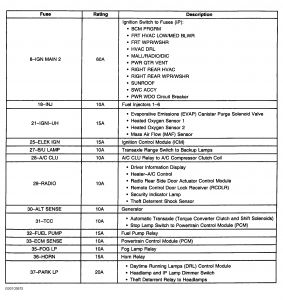

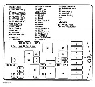

Underhood junction block is located on the front right side of the engine compartment, near battery
Best if you use a test light or a volt meter and check fuses with lights on
fuse # 37 associated with the IP lights
