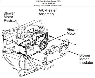

Where is it located?

The resistor is located on the blower motor housing and the diagram shows its location. Blower motor is located in right side of engine compartment. After disconnecting the blower motor and resistor wire electrical connectors, remove the retaining screw for the cover and after removing cover, you would be able to remove the resistor.
https://images.2carpros.com/forum/automotive_pictures/192750_BlowerMotor02ExpressFig16_1.jpg
