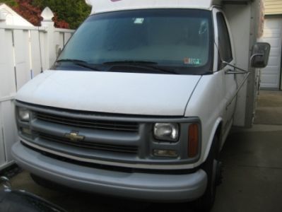

No, it's not diesel. Sorry about the bad description, it's a Chevy 3500 TK (that's how it's listed on the registration card...to me it's a Chevy van, with a box in the back, tool compartments on the sides.), 8 cyl, 5.7 liter, and it shown on the picture attached.

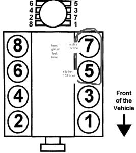

This is the firing order of the van, look at the cylinders that are misfiring carefully.
https://images.2carpros.com/forum/automotive_pictures/46384_firing_order1_1.jpg
There are many sealing points withing the combustion chamber that must operate properly to provent lost of power. Spark plug gasket or seat: that is unlikely for two adjacents cylinders. Iintake valves, Exhaust valves, unlikely for two adjacents cylinders. Piston rings, unlikely for two adjacent cylinder. Head gasket: most likely for two adjacent cylinders 5 and 7 .
