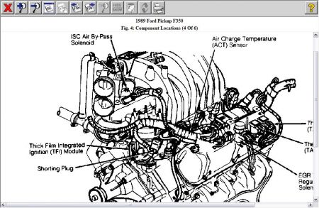

i have a 89 ford 1 ton with a 351 windsor, the truck starts for about 10 min. then dies, and it wont start again, for another 3 to 4 hrs.and does the same thing again. ive change every thing possible and no one here where i live has been able to solve the problem, ive change pick up coil, coil, madular,relay switch , wire , plugs, cap, rotor and still the same problem, can anyone heilp me, i realy would appriciate it thank you!

Try checking the ISC air bypass solenoid. Don' work when it dies out immediately look for spark and fuel one of this is gonna be missing. Also might want to check the fuel pressure could be the fuel pump getting sloppy. Also test out the ECU power relay
https://images.2carpros.com/forum/automotive_pictures/12900_idle_bypass_1.jpg

I want to thank you for your reponds to my truck problem, i sure hope that by checkiing these things it will work, thanks again! by the way where can i get the picture which you showed me?
@ www.ondemand5.com click on Mitchell1 top center of page and go from there should be on the left column for manuals next page.
