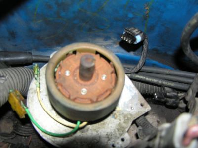

DAVE OTT
  • 5 POSTS
How about this rust monster and melted wires
https://images.2carpros.com/forum/automotive_pictures/83376_truck_distributor_006_1.jpg

Okay new distributor helped it run a little better still same smoke problem
