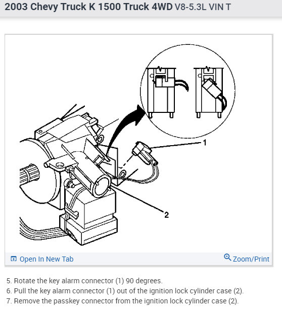

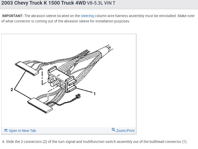

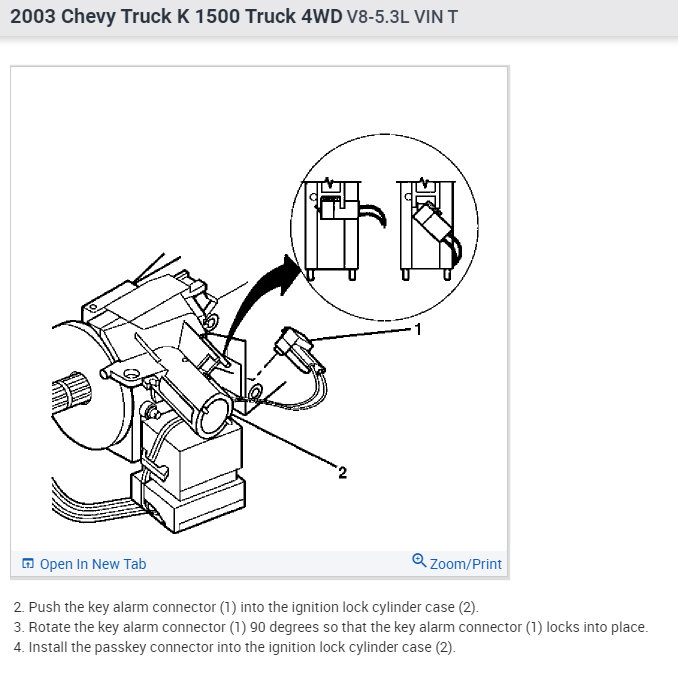

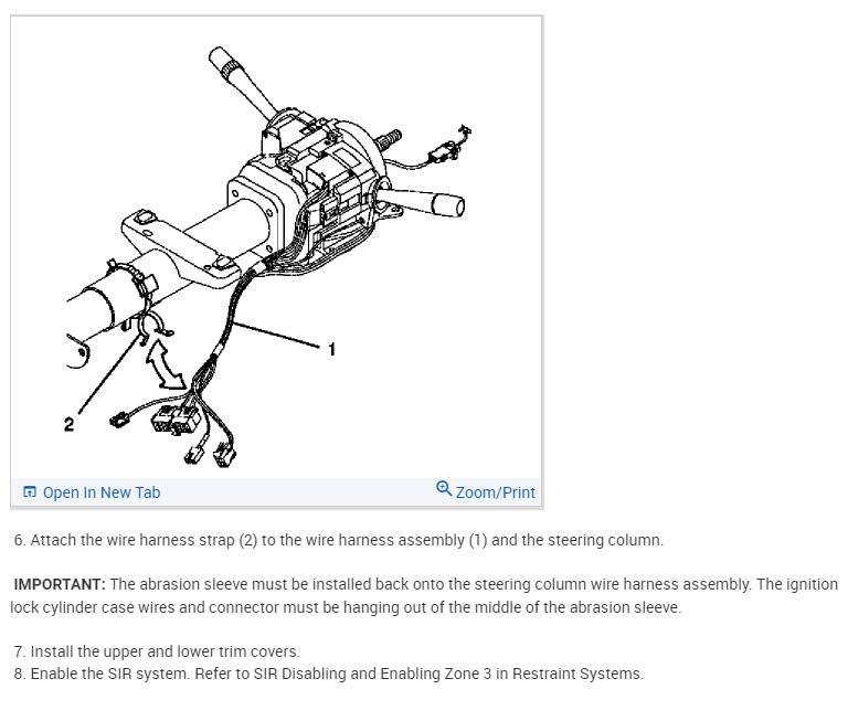

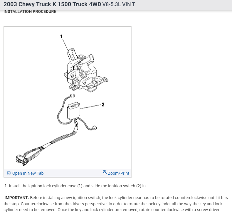

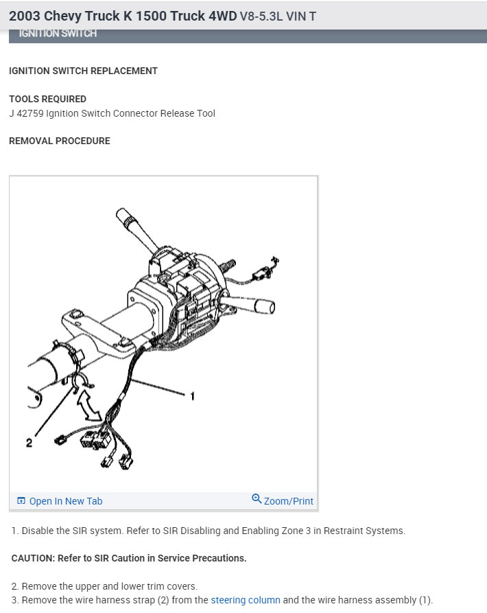

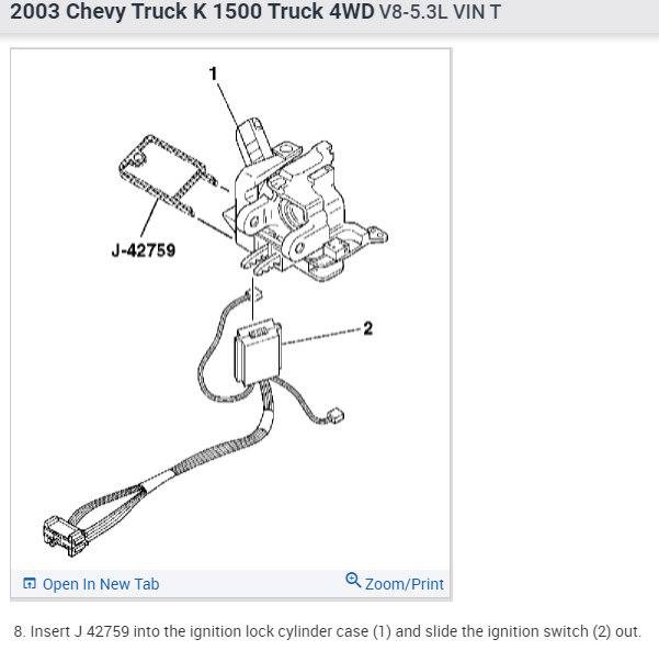

new ignition switch in about a month ago and now all the gauges does not work
2003 CHEVROLET TRUCK
ORANGE 68
i put a new ignition switch in about a month ago and now all the gauges does not work. they all are about half way up, tac,h mile per hour ,temp, volt also message center,or bell is not working
Jul 14, 2009 at 8:01 AM
SQM
  • 6,383 POSTS

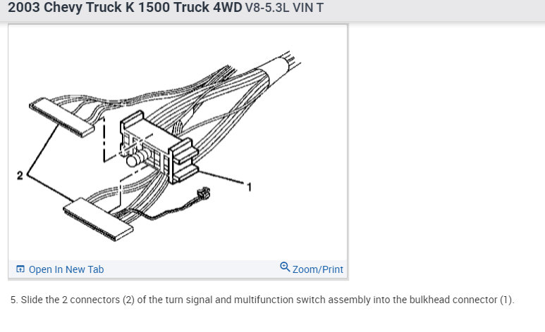

If this issue started after the install of a new ignition switch, then it is likely due to a faulty switch or bad / loose connection during the install.
Best course of action would be to replace the ignition switch, as the issue did not exist before the replacement.
Replacing the ignition switch requires the removal of the steering wheel.
Remember to take extra precaution when working with airbag inflator. Never point the inflator to your body.
Here is a helpful guide:
https://www.2carpros.com/articles/steering-wheel-removal
