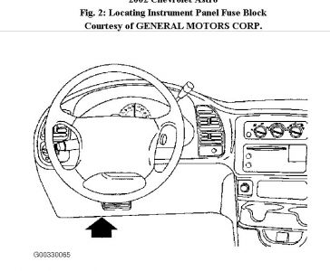

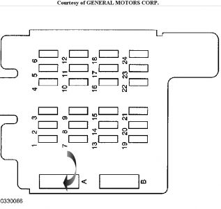

How would I find the fuse that would operate the power door locks in a 2002 Chevy Astro Van? I would hate to have to bring it in to have it taken care of but I can't figure it out. :roll:

https://images.2carpros.com/forum/automotive_pictures/30961_ast1_1.jpg
circuit breaker A.
https://images.2carpros.com/forum/automotive_pictures/30961_ast3_1.jpg
