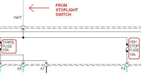

i have all my brake lights working in my rear of the truck but my brake lights dont come on. also i was wondering where you got that picture of the wiring diagram and if you could send it to me so i can trace out the brake switch wiring

my park lights work as do my back up lights and my turn signals, but when you press the brakes nothing happens even my third light works just not my left and right side. i have replaced the stop light switch and the turn signal switch as well as the circuit board where you put the lights on. i am trying to trace the wires but caint seem to find a diagram to follow the wires off the stop light switch

Oh, ok. Well I have the wire diagram but it is extremely large so I can't post it because it would not be readable. I can post the section with the stoplight switch though.. it only has 2 wires , 1 orange and the other white. The orange wire goes to the STOP LPS fuse while the white wire runs to the CHMSL Fuse & the VEH STOP fuse. Have you checked all 3 of these fuses?

i have checked all fuses and they are good also my brake light switch has more than two wires. a orange that is hot a white the when brake is depressed powers up. a green that runs to the turn signal switch.i aint sure about the rest but i think one runs to the with that allows you to move from park to drive. the white wire i followed it up towards the fuse panel where it splits one towards the fuse and three towards the fire wall. can you send the diagram to my email to where i can see it or is therer a place to go to find exactly where the wires are going.
