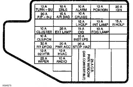

Well my horn wont beep, took it the mechanic for inspection,he wont pass it. If it is a fuse the mechanic couldnt find it, he didnt know which was which cause the fuses weren't marked.. Can you tell me the particular fuse he would need to change IF that is the problem. ALSO, IF its not the fuse, what else could be the problem??? JESSICA :?: :?

hi jessica , im sorry to hear you mechanic could not find a fuse , lol thats too funny but anyway the fuse for the horn also runs you interior lights , so if they arent out chances are its something else , like a horn relay or the horn itself , or the turn hazard headlight switch assembly here is the fuse location the box cover should be marked with this but its for cig,,,, look at the pic and the fuse box it should match up , you may have to count over and down but here it is thanks, jim oh and leave some feedback if you were happy with your help , we all donate our time here helping others
https://images.2carpros.com/forum/automotive_pictures/59481_fuse_1.jpg

Well thanks for the diagram of the fuse box that should help..BUT what you were saying about the dome light.. My dome light never goes out,(i had to pull the bulb out of it so it doesnt drain the battery) and my HORN doesn't beep. NOW the horn not beeping was going on for a few months.. but the dome lite, being on where i had to disconnect just started happening a few days ago after i got the car back from the body, shop. Are these two things related? and how do i fix them?

ok well yall went about it the right way, but in a cavalier the domelight and horn have nothing to do with each other, its the horn and cigarette light, check your lighter if it does not work then get a blue (15) fuse, and replace where it says cig. light.

no we are not saying it will work for sure this is the starting point , pull the cig fuse and see if it is bad if you have doubts replace it and see what happens , the fuse is less than a dollar
