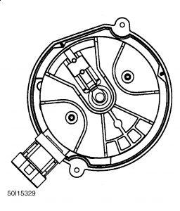

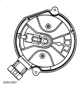

After beating crank sensor on the floor, my spark returned. Replaced the new sensor, truck runs but set a p1345. Reinstalled dist. Many times, had timing at many locations, but can't get it down to 0 or 2 deg, 14 adv was the best, but can't do that again. It hangs out at 22 or 24, will adv a few with throttle, I have seen 31 once. Anybody?
Thursday, August 13th, 2009 AT 3:06 PM
JLAFOLLETTE
  • 8 POSTS
As a supplement to the above question, I have followed the procedures described in manuals and Alldata. Com on dist installation. My aftermarket dist does not have an "8" marking as the target for rotor location on final placement, but I have had the rotor pointiing at #1 contact and the engine atTDC on compression stroke, and moved it 1 tooth each direction as well as rotated the dist housing to try to pick up 0 degree timing, with code cleared. It wouldn't drop down or even respond to changes. It isn't frozen on 24 degrees, as it will increase in timing with throttle application a few degrees. I've read some chatter about crank relearning, but there hasn't been any reference to it in instructions for dist replacement.
Thursday, August 13th, 2009 AT 4:57 PM
DOCFIXIT
  • 18,828 POSTS
Assume you goy new crank sensor after beating on floor? Your aftermarket Dist. is it replica of GM? can old dist be used? Here are some pics of dist placement. Align pin hole in gear with paint mark on shaft. Refer to old dist. align rotot as in fig. 9 install should end up like fig. 10.
https://www.2carpros.com/forum/automotive_pictures/198357_Graphic_57.jpg
https://www.2carpros.com/forum/automotive_pictures/198357_Grafic_3_11.jpg
first fig.8 then 9 then 10
https://www.2carpros.com/forum/automotive_pictures/198357_Grafic_4_2.jpg
Friday, August 14th, 2009 AT 8:46 AM
JLAFOLLETTE
  • 8 POSTS
Yes, replaced Crank sensor. Old dist had bad bushing and drive gear, that's what took out the old motor. There won't be a white line to align to, as that would be if you were re-installing original dist. The new NAPA dist is similar enough, meaning that ultimately my target is to have the rotor pointing at the beginning of the flat part of the casting which is actually #1 cyl. I get that part, that's old school. I'm confident in the dist placement, my problem is that it still shows 22-24 deg adv on the scanner, and adjustment or even moving a tooth doesn't affect it. Two teeth makes it crossfire.
