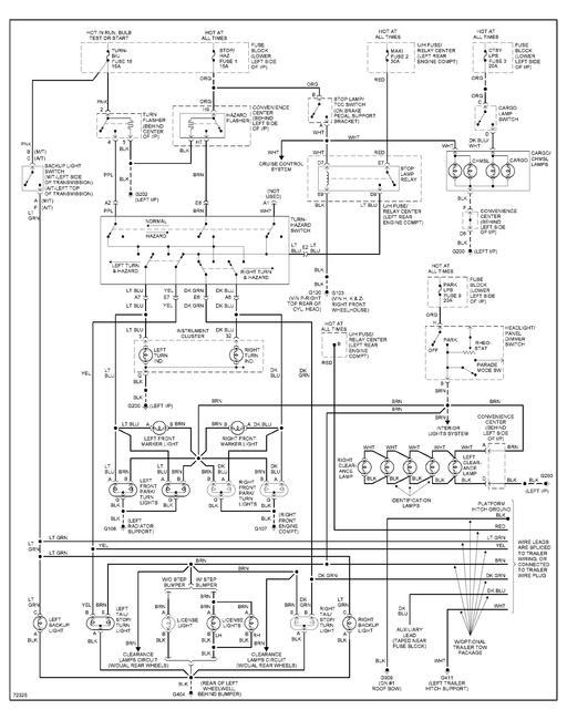

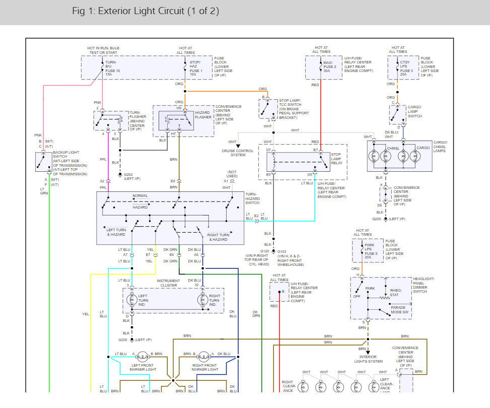

It sounds like the headlight switch is bad but to be sure here is a guide and the tail light wiring diagrams so you can see how the system works and which wires to test for power.
Check out the diagrams (Below). Please let us know what you find. We are interested to see what it is.

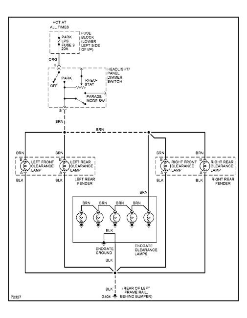

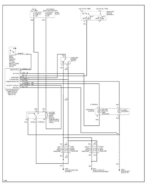

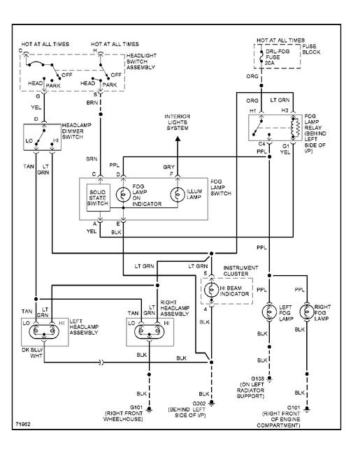

i got you 6 diagrams..........you will only use 3......the correct ones for your truck
"drl" is daylight running lights
composite is plastic headlights......the ones that get all hazed over in the sun
sealed beam is the "real glass headlights" ....like i grew up on
diagram:

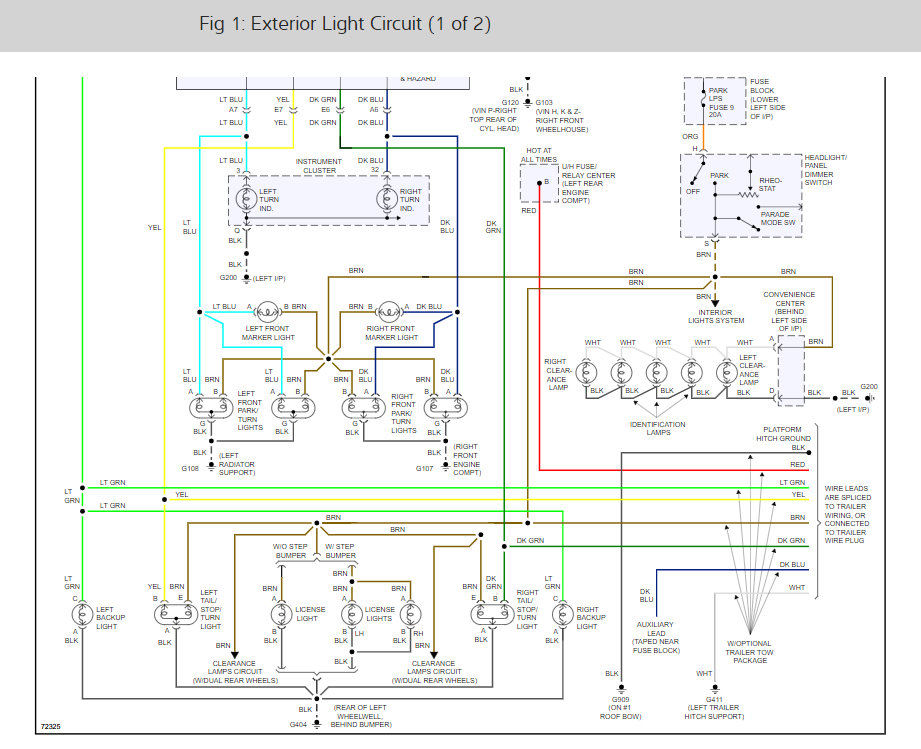

1) exterior lamps---1 of 2 (keeper)
2) exterior lamps---2 of 2 (keeper)
take your pick on these---only one is you:

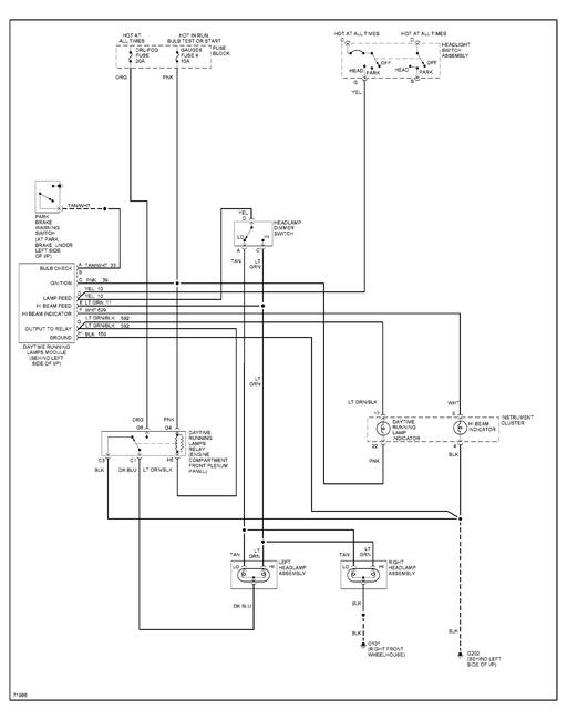

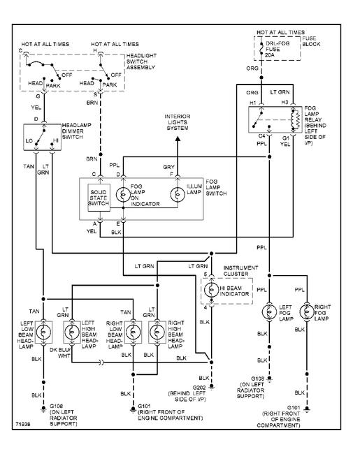

3) headlights composite w/ drl
4) headlights composite w/o drl
5) headlights sealed beam w/ drl
6) headlights sealed beam w/o drl
lemme know that these aided in your fix!!!

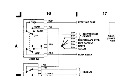

Is there a brown wire coming off head lamp switch? That wire should carry voltage for tail lamps and other. The headlamp switch has two circuits. One side of headlamp switch is a circuit breaker, only for headlamps. The other side of headlamp switch controls feed for other lighting, including the tail lamps. I believe there is a different voltage source for each side. I'd want to check voltage sources to and from the headlamp switch, before condemning the switch.

Here is wiring for headlamp switch.
